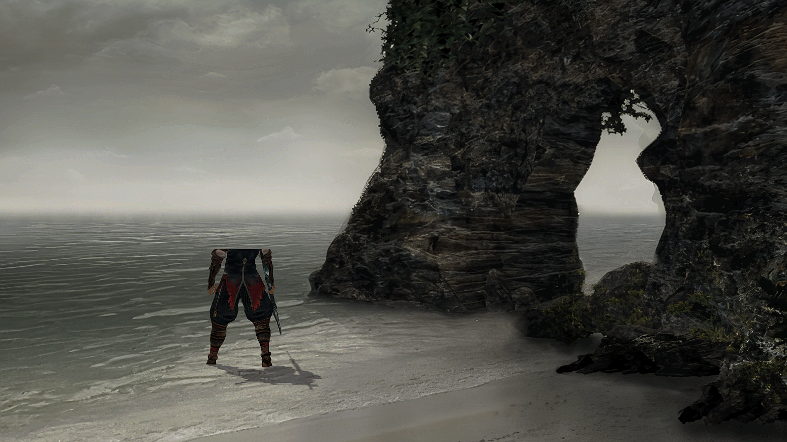

Just brought the game and it shows lots of "aura" glitches on every character.
Posted on steam community and every users with Intel Iris XE GPU got the same issue.
My laptop specs:
I7 1665G7
20GB Ram DDR4 3200mhz
SSD 1TB
Screenshot below.

Hello guifro,
  1. What is the brand and model of your system?
  2. Please share the screenshot of the Graphics settings of the game.
  3. What is your game launcher?
  4. What are the troubleshooting steps that you tried so far?
  5. For me to review the hardware and the driver installed, please help generate the SSU logs of the system. Please refer to the link below for the steps:

1. Asus Vivobook X513EAN. Windows 11 22H2 26100.6725
2. Screenshot attached
3. Steam
4. Already tried to install older graphics driver and every graphics settings ingame. No sucess
5. SSU Log Attached.
Thanks!

Hello guifro,
Thank you for the update.
Before we proceed, let me also set the expectations that you are using a 3rd party OEM system, and our support may be limited to drivers. #rd party OEM system units can alter, enhance or modify the controllers and to enable those changes, they may have their own set of drivers.
For this issue, please try to install the latest Intel generic driver using DDU method and update me if there will be changes, here are the steps and the download link:

Tried both. The Asus OEM driver and the lastest from the Intel website support.
I've installed the first one and got the same graphic errors then, fresh installed Windows 11 with the Intel lastest driver and nothing changes.

Let me check, have you tried contacting the game developer if your system can run the game?
I checked the system requirements and the minimum requirement for Graphics is Arc A380.

As guifro previously reported, several people are having this graphics issue with the Intel Iris XE (see Steam forums and Reddit).
The problem doesn't necessarily seem to be the minimum requirements of the game, as it runs smoothly with an integrated UHD 770 graphics card (which, however, seems less powerful than an Intel Iris XE and is in any case below the ARC A380).

Yes, i've checked. The game runs well and smoothly at 60 fps with no drops.
Last night, i've run it on Ubuntu with custom Mesa driver and it worked perfectly.
I've to say, right now, we have a driver problem on Windows.

 After reviewing the details, it appears that the game currently does not meet the system requirements specified by the developer for your iGPU. We recommend contacting the game developer directly to see if they plan to add support for your integrated graphics in future updates.

Michael, I think there is an overlooked issue here; while the game does ask for "Resizeable BAR", or ReBAR, after further review, it seems that although the feature may be supported by a user's system (in my case, a Dynabook Tecra Portege X-40J running Windows 11 with an 11th Gen Tiger Lake 1147 processor), Intel Xe graphics currently do not support the feature even if it's enabled in the BIOS or reported as being supported by the OS.
Under GPU-Z, I can see that Resizeable BAR is enabled -- however, upon clicking the word, "Enabled", I was able to verify that (A) Resizeable BAR is enabled, (B) GPU hardware support is listed as "Not Supported", (C) "Above 4G Decode Enabled in BIOS" shows Enabled, and (D) Resizeable BAR Enabled in BIOS" lists "Unsupported GPU".
From these determinations, we can logically conclude that ReBAR isn't possible for IrisXe iGPUs, despite other system configuration supporting ReBAR IF it were supported by the iPGU. While it is possible that the developer depends on the functionality, said functionality could be enabled via a driver update to support this technology.
A driver implementation (via update) could theoretically enable ReBAR support at the iGPU level -- which again, from the other evidence collected, seems to suggest that it is indeed possible to leverage on our systems. Further weight to this argument can be found in other users who do have dedicated Arc graphics cards, but for whom the issue still persists. Testing enabling this functionality on existing first-gen Iris Xe iGPUs could lay the foundations for a successful patching of Arc GPUs as well. In an age where users are beginning to consider Intel products for a consumer's GPU needs, working with Square Enix or providing an updated driver for a popular remasters of a timeless classic would be a good way to show the gaming community that we are taken seriously. "Intel enables Resizeable BAR functionality for X GPUs" would make for a nice headline, I believe.

2026年4月末でThe Ivalice Chronicles発売から7ヶ月ぐらいになりますが、以前としてキャラクターにかかるカラフルなカーテンが表示されております。
guifroさん、Patacrepeさん、Samantha1280さん、BenjaminAJさんが多くを代弁してくれているのを心強く思って拝見してます。
この表示バグはiris Xe Graphicsの性能不足というよりは、ドライバの改良余地があるのではないでしょうか。似たような表示バグに鬼武者2もありました。
私の環境ではwindows 11 25h2 OSビルド 26200.8246、11世代core i7-1165G7 iris Xeドライババージョン32.0.101.7085で1920×1080 60fpsで稼働しておりパワー不足ではなさそうです。
