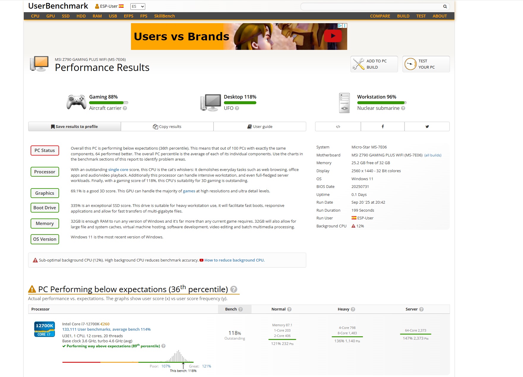

Uri_Fede
1,210 Views
The texture issue doesn't worry me as much since it's been happening to me since day one, and there are more cases with the RTX 40 series, and it seems to be something with the game's LOD engine when using very high graphics.
The performance issue does worry me.
It all started when I switched from the i7 10700k to the i7 12700k. Everything was running perfectly, but sometimes it stuttered (turns out it was an issue with the new 24H2 version; the stuttering was fixed with 23H2). To run some tests, I disabled hardware acceleration in Windows, and that's when the performance issues started: a lot of stuttering, strange vertical lines, etc.
I don't know if this helps with the diagnosis.
I tried to re-enable hardware acceleration, but the GPU didn't perform as well as before. I'm noticing that some games are no longer reaching the FPS they used to, and the lines are strange even with a good FPS.
I reassembled the i7 10700k, changed the power supply, etc., and it still doesn't perform well. I also tried Windows 10, reformatting for Windows 11 23H2, and nothing.
Before disabling Windows hardware acceleration, I didn't have any of these issues.
Now I'm back to the i7 12700k, and I still notice that the GPU isn't working as well as it used to.
I don't know if the BIOS has been corrupted or damaged, if there's a way to get the GPU back to its previous state, or if I need to update the BIOS, or if it needs to be checked.
Best regards.
Uri_Fede
1,201 Views
I attach the test
