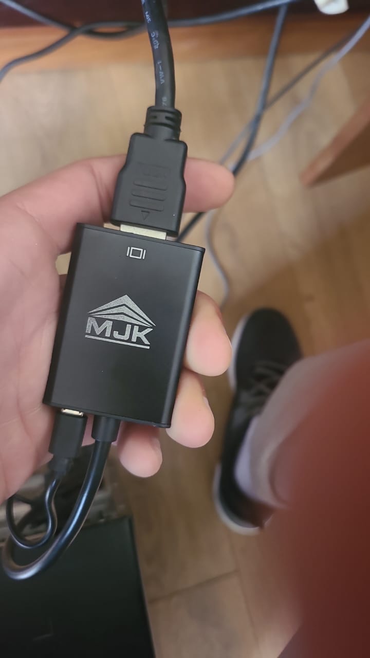

Output Types 2 VGA, 1 HDMI (Connected to a HDMI VGA converter as my desktop is old and doesn't have a HDMI port)
I attached the report and 2 pictures of the case with everything connected (Sorry not a pro)

Please unplug the three video cables from the PC and take a photo of the connectors on the back of the PC.

No. I want to see a picture of the back of the PC with the cabling disconnected.

Hope those are correct

So, you have two DisplayPort ports and one VGA. Which of these ports is not working? If the problem moves around, please detail what you have tried.

Windows 10 Pro 64-bit. This computer is not designed to run Windows 10, and there is no graphics driver specifically compatible with Windows 10. Have you recently upgraded to Windows 10?
Dell says:
3rd generation CPUs natively support 3 displays with the integrated CPU graphics. Three simultaneous display output requires one DisplayPort [9] with a maximum resolution of 2500 x 1600 @ 60 Hz and a DisplayPort [9] and VGA [11] port with max resolutions of 1920 x 1200 @ 60 Hz.
According to the diagnostic report, the system currently registers 2 monitors:
Samsung SyncMaster S23B300
1920 x 1080 @ 60 Hz
1 x DVI-D
1 x VGA
Generic non-PnP monitor on HD15
1600 x 1200 @ 85 Hz
One Video Graphics Array (VGA) connector is a 3-row 15-pin HD-15 connector as shown above [11].
You have quite a few adapters in use. I understand that it worked that way before (even with Windows 10 ??), but unfortunately interoperability is more difficult to maintain every time the transmission protocol changes.
Make connections that are as straight as possible:
What ports do the other two monitors have? Manufacturer and model?
