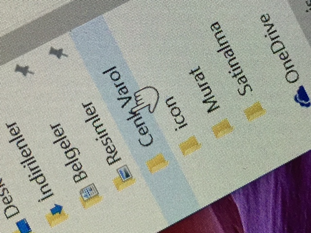

Hello ,
Asus UX305UA has resolution 3200x1800 QHD Display. After the initial setup is complete the display settings , text, and application size as Windows 10 was recommended by %250. This is the default image There is no shortage of reasonably good quality but quite difficult because the use of text icons, screen looks big.I set the size to 125% , I have the image size should be. But the text is blurry. When I contact with Asus Co. they said that I should update to Intel® Beta Graphics Driver for Windows® 7/8.1/10* [15.40]. After has been Installed. The problem could not be resolved. In addition there are pictures. This issue affects my eye health .
What are your suggesiton ?

Hello, cenkv:
There are three different drivers that you could use in your system.
The most recommended is the OEM driver, this is to avoid loosing any special features or settings added by your OEM that would not be available while using other drivers.
With that said, here you can find the 3 drivers you can use to test your system:
1. OEM version: Version V20.19.15.4300 // https://www.asus.com/Notebooks/ASUS-ZenBook-UX305UA/HelpDesk_Download/ https://www.asus.com/Notebooks/ASUS-ZenBook-UX305UA/HelpDesk_Download/ please select OS and look for VGA driver.
2. Intel® generic drivers: A. https://downloadcenter.intel.com/download/25749/Intel-Beta-Graphics-Driver-for-Windows-7-8-1-10-15-40- Download Intel® Beta Graphics Driver for Windows® 7/8.1/10* [15.40] 4380
B. https://downloadcenter.intel.com/download/25484/Intel-Graphics-Driver-for-Windows-7-8-1-10-15-40- Download Intel® Graphics Driver for Windows® 7/8.1/10* [15.40] 4300
C.https://downloadcenter.intel.com/download/25620/Intel-Graphics-Driver-for-Windows-7-8-1-10-15-40-6th-Gen- Download Intel® Graphics Driver for Windows® 7/8.1/10* [15.40 6th Gen] 4352
3. Generic drivers from Windows 10*, you can get them by uninstalling the current driver from device manager and letting Windows 10* install the defalt after rebooting your system.
I look forward to your outcome with this.
