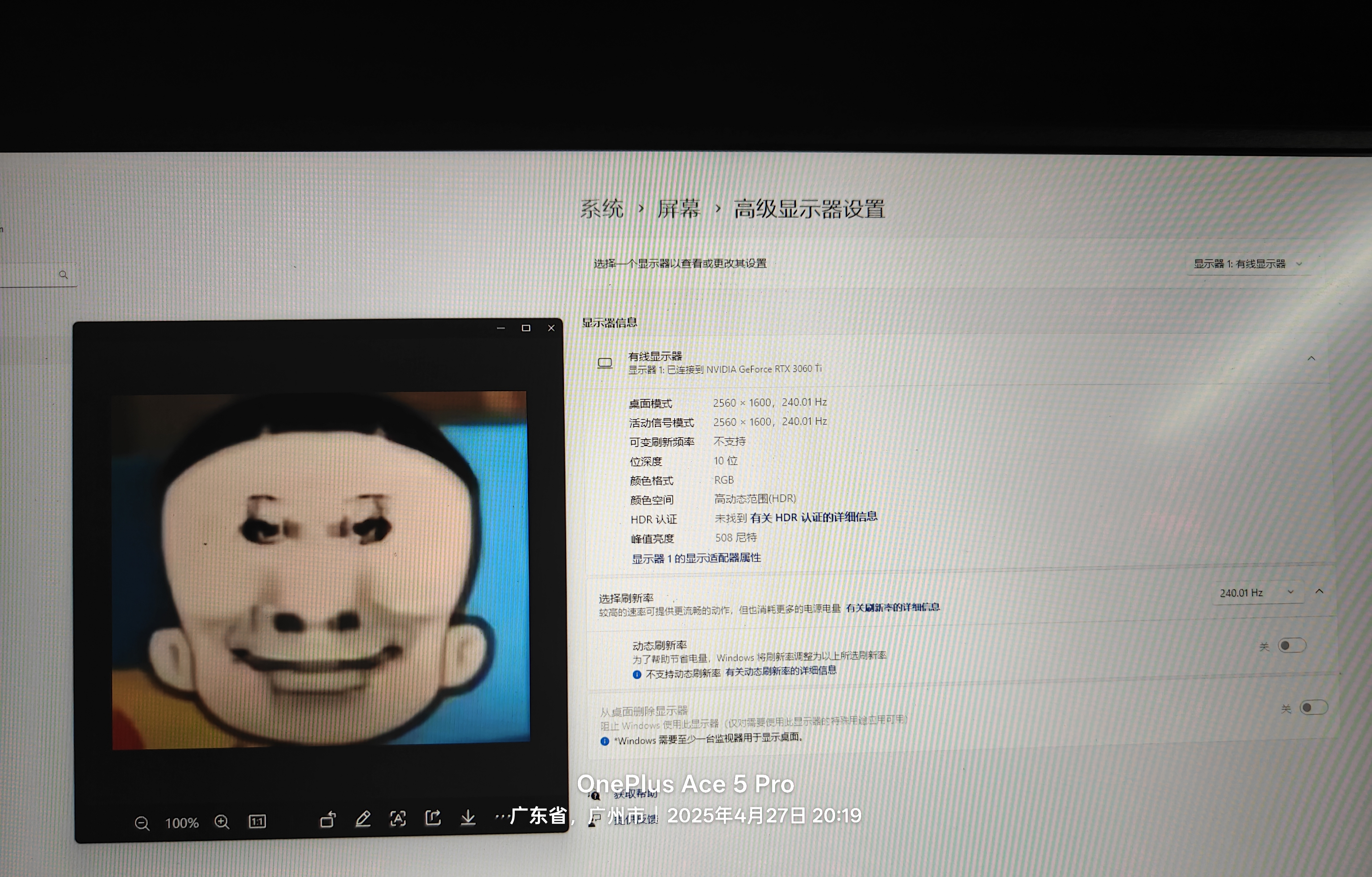

As requested, I have generated the EDID report using edid-text.exe and attached it to this message. Additionally, I have taken photos of the screen output with both the Intel B580 and NVIDIA RTX 3060 Ti GPUs when HDR is enabled.
These images clearly demonstrate the following differences:
  • Intel B580 with HDR enabled:
    • Lower brightness compared to the NVIDIA GPU.
    • Noticeably washed-out/grayish appearance, similar to an improperly calibrated HDR display.
  • NVIDIA RTX 3060 Ti with HDR enabled:
    • No brightness reduction or color degradation — HDR operates as expected.

I can see the difference in your screenshots, yes. The peak brightness is also displayed differently in your Windows display settings:
  • Arc B580: 440 nits
  • GeForce RTX 3060 Ti: 508 nits
The 508 nits are in the EDID that the display sends to the computer. Where does the Arc B580 get the value 440 from? Are the screenshots from before or after running the Windows HDR Calibration app and activating the Windows color profile? If the color profile doesn't make a difference, you can also remove it again:
Don't forget to restart.
After removing it, does the peak brightness on the Arc B580 show 508 nits again?
