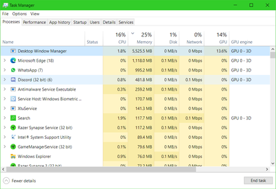

Here's a screenshot of my dwm ram usage after 2 hours (1.6 GB):
Please, this bug is already known for 3-4 months, and I do not want to reinstall a 2019 driver...

I want to make a little input on the bug, cause i've been dealing with it from more than a month restarting dwm via processexplorer64, but i normally shutdown the pc with fast boot deactivated but the laptop takes a lot of time booting up (~10m or more). I deactivated hibernation too so i can check if that helps with the booting speed.
Also, i'll post here some pictures of how many memory dwm allocates on both ram and swap of different days i have saved on my laptop.
My laptop (Acer Aspire A515-51G) details:
  • Windows 10 Home Single Language v2004 10.0.19041(.448?)
  • Processor: i5-8240U @ 1.60GHz
  • Bios and motherboard info on a screenshot
  • 1x8GB ram, 13,6GB page/swapfile
  • Dedicated Graphics card Nvidia GeForce MX130
For this bug i had to install Rainmeter+SysDash for monitoring ram/swap usage always before my pc get stuck. It started to happen after someone told me to use Intel Driver Assistant for recieving driver updates.

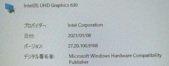

Hi @AndrewG_Intel
I have the same problem in my customer and our application has crashed by not enough memory.
Do you have any other opinions?
・Customer's PC operates 24 hours a day, 365 days a year.
・A graphical application that I created to monitor a certain device is running from startup.
・Not connected to the internet.
・Unnecessary services and applications are stopped.(ex. Windows update, antimalware service, Windows Definder and other...)
The condition of occurrence has unknown, but it occurs in the following pattern.
- a few months after reboot
- a few days after the power is turned on (not reboot)
Customer PC information are :
Processor : Intel(R) Core(TM) i5-9500 CPU@3.00Hz
RAM : 4GB
OS : Windows 10 pro 2004 Build 19041.388
Graphic Driver :  Intel UHD Graphics 630 Ver.27.20.100.9168
(I'm sorry the screen shot is in Japanese.)
