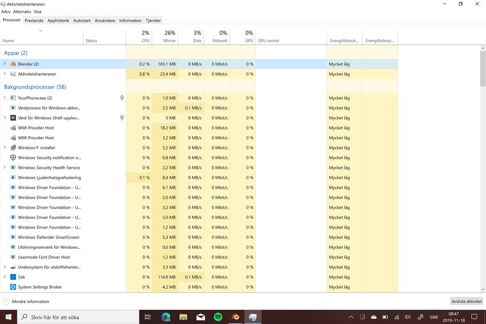

I have recently bought a Surface pro 7. And i cant use my main 3d program blender on it, it is too laggy too have an efficient workflow. I have the older version of Microsfot Surface pro 4 works fine in blender 2.80. I have installed the older version of Blender 2.79 and this works fine on both devices. This is out of the box products freshly installed no plugins only the 3d program and only a single cube in the viewport. I belive this problem is centered to the iris graphics and i have a forum post with more details here.

Please send us pictures of the task manager when you use the Blender version 2.80 and 2.79 to check the differences in (CPU usage, GPU, memory, etc).
Please provide steps to try to replicate the issue and if possible send us a sample project.

In this video recording i try too explain the problem and how it shows up and affects me.
https://www.youtube.com/watch?v=bhk00eO_Zec&t=177s i have tried too suply you if all infromation i can, hope this is enough if not plz write e again.
