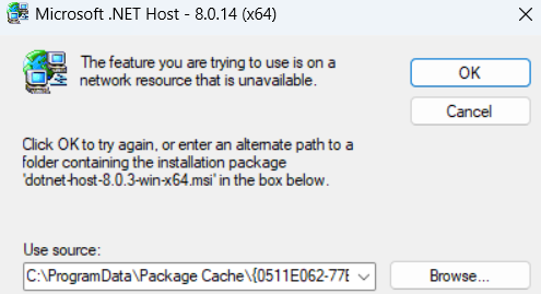

i have tried to find the folder by my self but it seem impossible. i have tried uninstalling DSA and install again but did not work
clearing temp file didnt work too.
im having this problem since last year.

found solution. from control panel -> uninstall program and fixing microsoft .NET and then running the DSA works

To uninstall/clean the remains of the old installation, download and run Intel DSA Uninstaller.  See also How to Uninstall the Intel® Driver & Support Assistant (Intel® DSA)
To install Intel DSA again, download and run Intel DSA Installer

i have tried uninstall and install back again. there was no difference
