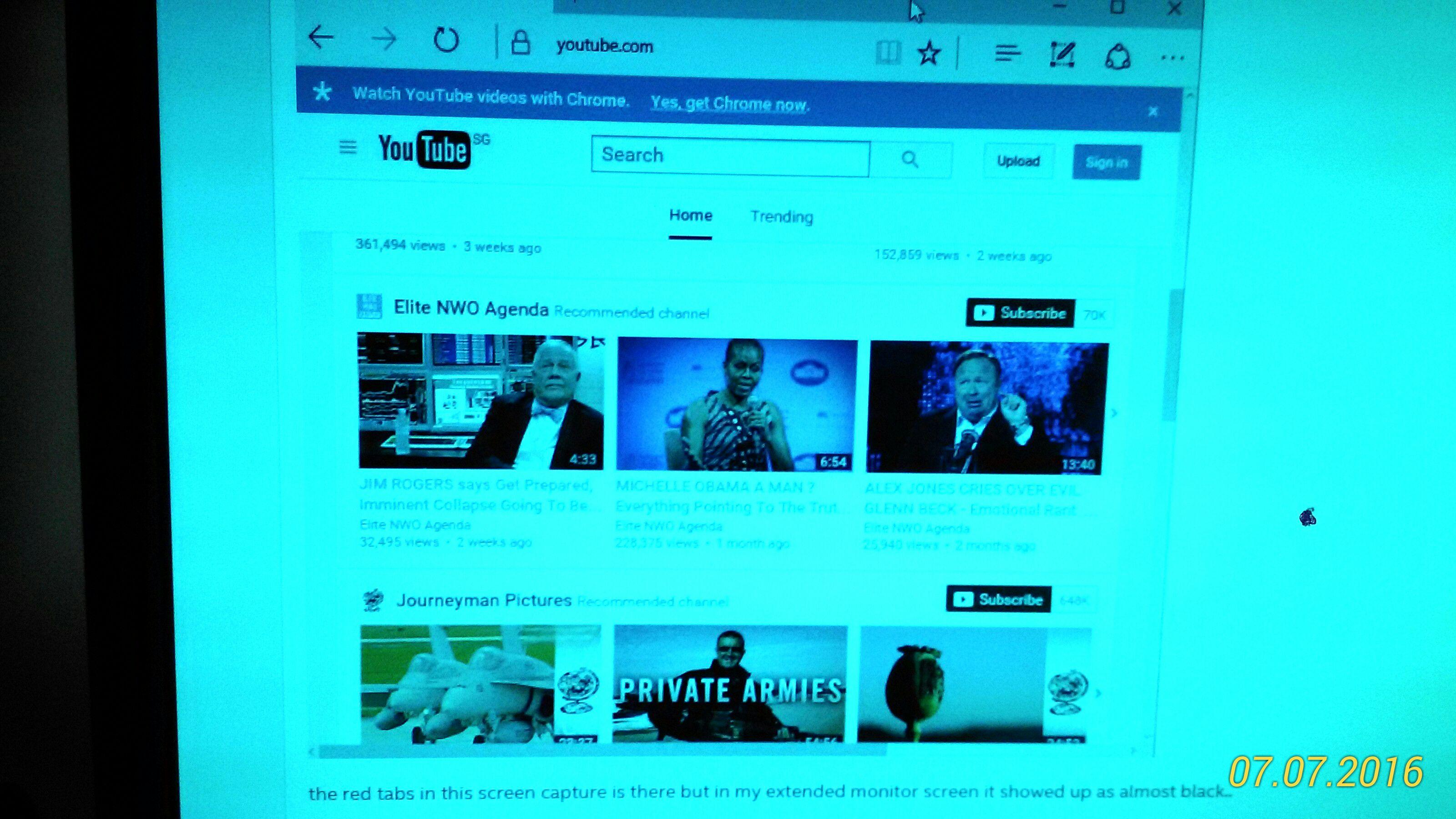

hi mike, I have anthr problem now. it seems that my extended monitor color calibration is completely out. I have tried the advanced display settings going through color calibration. adjusting gamma, brightness,contrast.. noticed that i can't 'put' the red color back. so need your assistance again..
the red tabs in this screen capture is there but in my extended monitor screen it showed up as almost black..

Hi murfyang,
I suggest you to reset graphics settings to default then, customize monitor settings. You can do it pressing + + F8

Hi murfyang,
Reset Windows display settings (Color Calibration) then, reset Intel graphics settings.
The issue is happening with the second monitor. Let me know brand name and model of it, type of video cable and adapter that you are using.

myang24
6,493 Views
hi Mike, tried using another laptop & had the same problem.
so isolated: laptop not the problem. down to either monitor or the cga to vga cable.
change VGA cable, solved the problem!
apologies for taking up so much of your time.
Thanks again!
