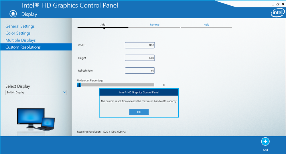

Screenshot_5.pngOk, so I am new here and would like to know something. On the intel about my display page it said that is was compatible with 1920x1080 61p Hz and I tried but can't. Please helpScreenshot_2.png

Why are you trying to choose 61Hz? You should be choosing 60Hz.

I know but look closely at the display info pic

That looks like a boo boo in the EDID data. If you cannot select and use this entry, create a custom one with 1920x1080@60Hz and try that.

Screenshot_1.pngSorry for the late reply but it also does not work

This limitation may be a bug in you PC's BIOS. Check with your system vendor.
