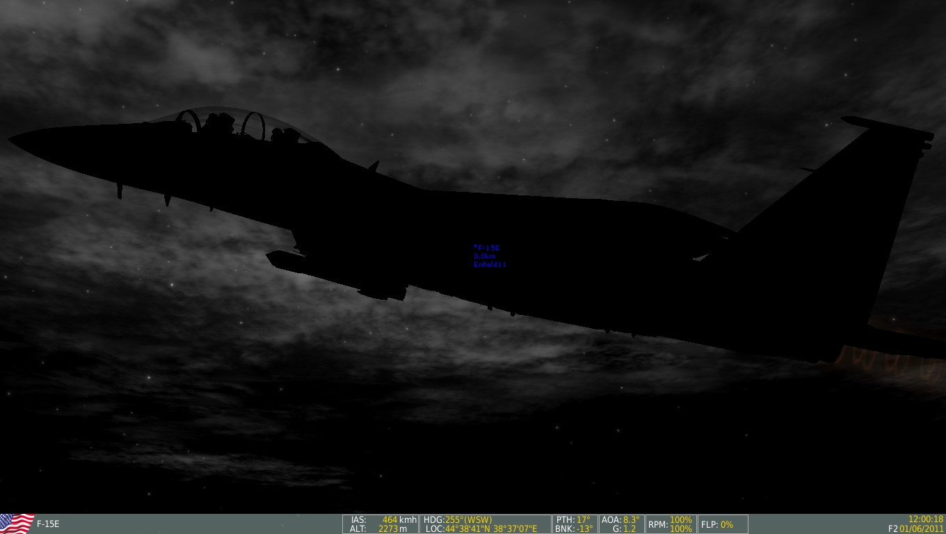

For some reason, the simulator made by Eagle Dynamics called DCS World 1.5.4 and DCS World 2.0 is not rendering any texture during a running simulation.
The simulation runs, but just no texture seems to be loaded or to be rendered. Don't know why and don't know if this is a GPU problem.
For clarity, i have added a picture that shows an airplane, but completely black, the air is black too, but clouds are rendered, and no ground textures...
This simulator runs perfectly on NVIDIA and AMD GPUs. For this test, i had configured all the settings on low, meaning, consume less memory, less complexity, no after processing etc.
Would appreciate if somebody from intel could have a look at this problem.

If you run the mission using an NVIDIA GPU, you'll see the graphics, but when you run on an intel HD 5xx architecture, the simulation runs, there are graphics, but no textures.

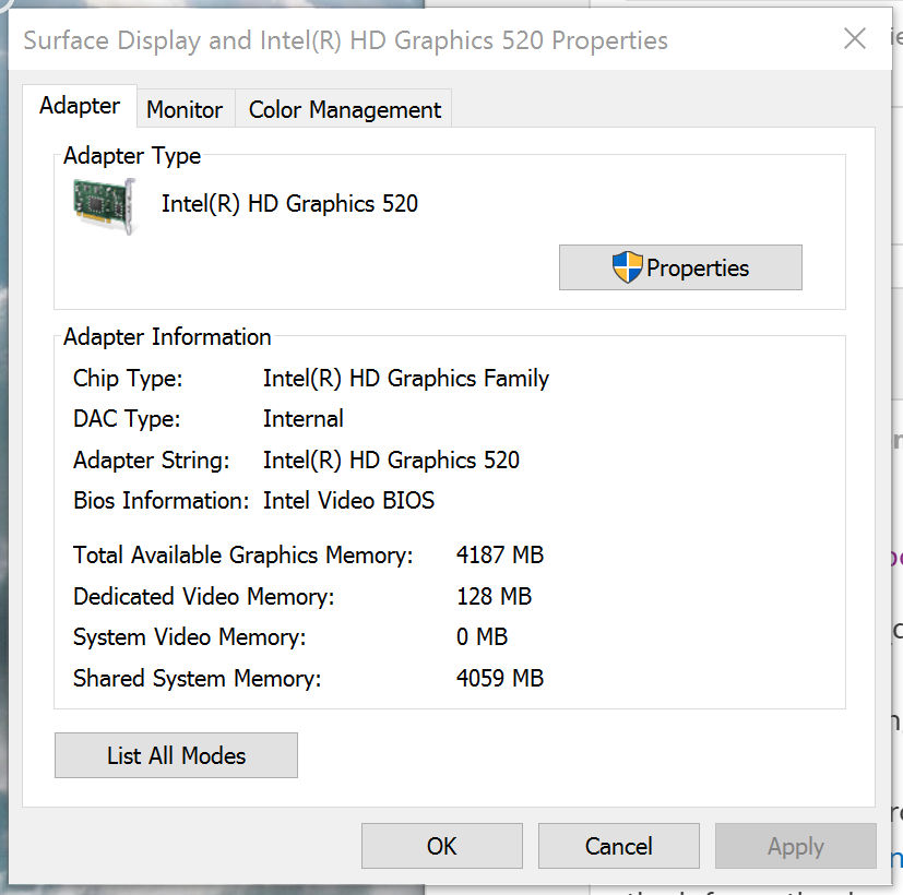

Hello there. Got the exact same issue with my surface pro 4 and DCS world. Couldn't find your report button anywhere though:
Would really love to have this sim supported as it looks like it runs well except for a majority of textures not loading. What's strange is that lower end computer are running it fine. Surface Pro 4 should be able to hand it too.
See the post of BADCrC please. Note that my surface pro 4 has only 4GB of memory, but his has 8GB of memory. The configuration that is showing up on his intel HD520 graphics properties panel should allow the game to run smooth.
Note, that on my other laptop (a PC with an NVIDIA 880M + HD4600 onboard), i disabled the onboard NVIDIA graphics card, and ran the game on the HD4600, and DCS world runs flawlessly on this setup.
When i check the HD4600 graphics properties on my laptop, it shows:
So there must be something with the intel drivers of the HD520 setup on the surface pro 4...

This is the best I could get for the external view. Sky is supposed to be blue. But from the cockpit, everything is black.

Sorry. The screen was taken with the 4463 as I have never been able to install the 4501. My Pro 4 kept telling me that I already have the latest drivers.
The screen looks good but actually, as soon as you are rotating around the aircraft, you get big black textures everywhere. Inside the aircraft also. Every instrument is black as well as the sky. Got only the structure and the clouds correctly rendered.

Sooo, are you telling us that your DCS 1.5.4 is working fine on your Pro 4? Because really there is nothing special to do to get those black textures. Just launching the game and arriving on the main screen you should see a partially black sky with moving clouds. Then launching any "immediate action" with any of the aircraft available (Su-25 or P-51), you'll get a almost completely black cockpit. Pressing F2 for the external view, you should see a lot of black sky and other black textures.

I have great news for you. We were able to replicate this behavior and there is a fix schedule for the next driver release, I do not have an estimate time for the release of this driver, but I recommend checking https://downloadcenter.intel.com/ Drivers & Software for further reference.

This is to inform you that we have already resolved the issue in our driver. We will update when the driver is available for you guys to download. Thank you for using Intel graphics. Please continue to submit issues so we can make your graphics experience better.
