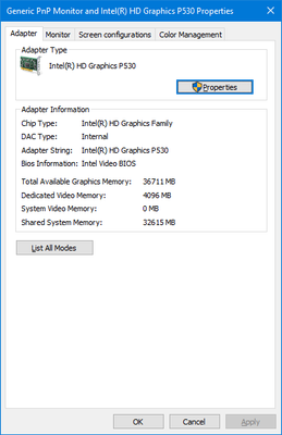

drvink
45,733 Views
I realize this is an old thread, but @n_scott_pearson is incorrect--this feature has not been removed from current (DCH) Intel gfx drivers. The location of the registry key has simply moved to meet Microsoft's "driver package isolation" requirements.
Anyway, the fix is easy:
  1. Find the registry key for your Intel GPU. It will be one of the keys under "HKEY_LOCAL_MACHINE\SYSTEM\CurrentControlSet\Control\Class\{4d36e968-e325-11ce-bfc1-08002be10318}" (look for a ProviderName REG_SZ entry with "Intel Corporation" as the data, or other values mentioning Intel GPU driver files--if you have no other GPUs, then the key should simply be "HKEY_LOCAL_MACHINE\SYSTEM\CurrentControlSet\Control\Class\{4d36e968-e325-11ce-bfc1-08002be10318}\0001").
  2. Add a new key called "GMM" under that key.
  3. Add a new REG_DWORD value called "DedicatedSegmentSize" under the GMM key--its data is interpreted the same as in the old "HKLM\SOFTWARE\Intel\GMM" location.
Image attached to show it works.

drvink
45,734 Views
