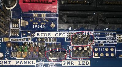

Bu Resimler 3 Tane Bios Jumper Giriş Yeri Var Bunların 3'ün dede 1 'er Jumper mı Takılacak Yoksa Sadece  1 Girişi 1 Tane Jumper'mı Takılacak.

n_scott_pearson
12,337 Views
One jumper will be installed into - or, in the case of BIOS Recovery, removed from - the BIOS Configuration header. Here is your picture with the proper header circled. The circle shows how to place the jumper for various things.
The strange thing here is that there should already have been a jumper on this header connecting pins 1 and 2. Normal operation requires this jumper bein place.
