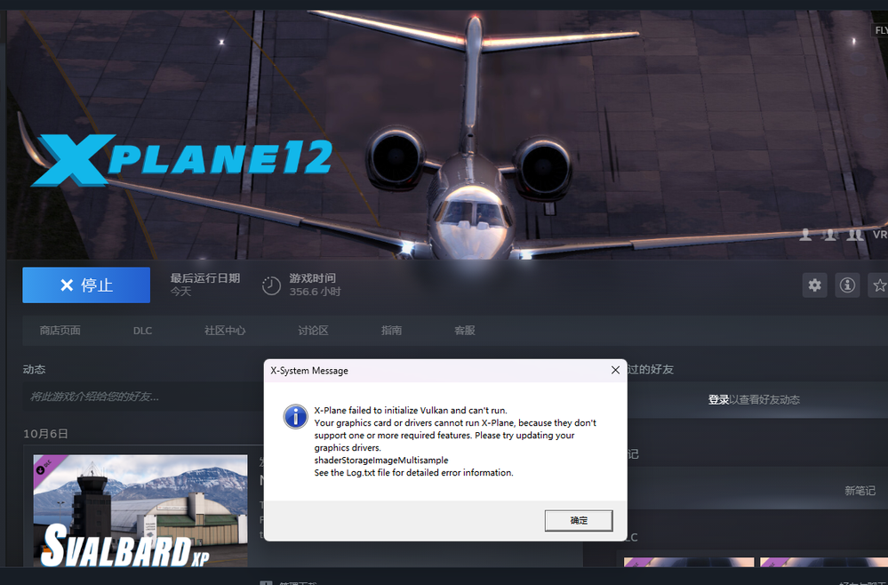

Driver 4885 still can not open XPLANE12 !It's too disappoint
gakki
840 Views
Driver 4885 still can not open XPLANE12 !!It's too disappoint.
Since i use arc750, I have never successfully opened this game again,
At least the driver update should can open this game.
Stefan3D
820 Views
Looks like you are out of luck with the implementation of shaderStorageImageMultisample
"The Windows drivers also retracted this feature on Alchemist cards... Currently we have no plans to support this feature there."
Source:
https://gitlab.freedesktop.org/mesa/mesa/-/issues/6052#note_1928842
