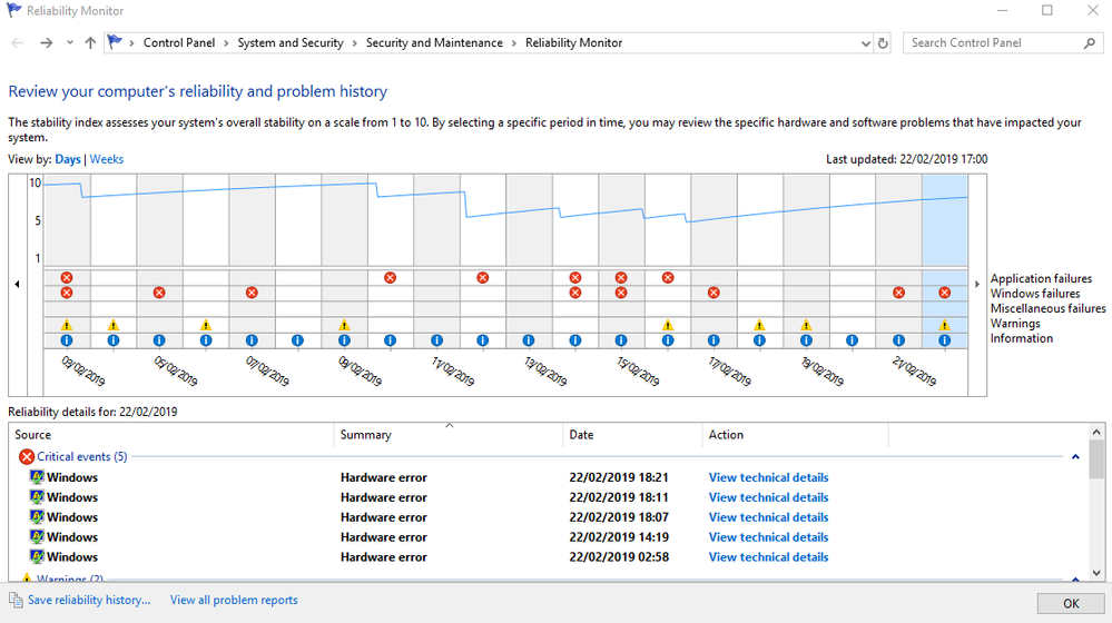

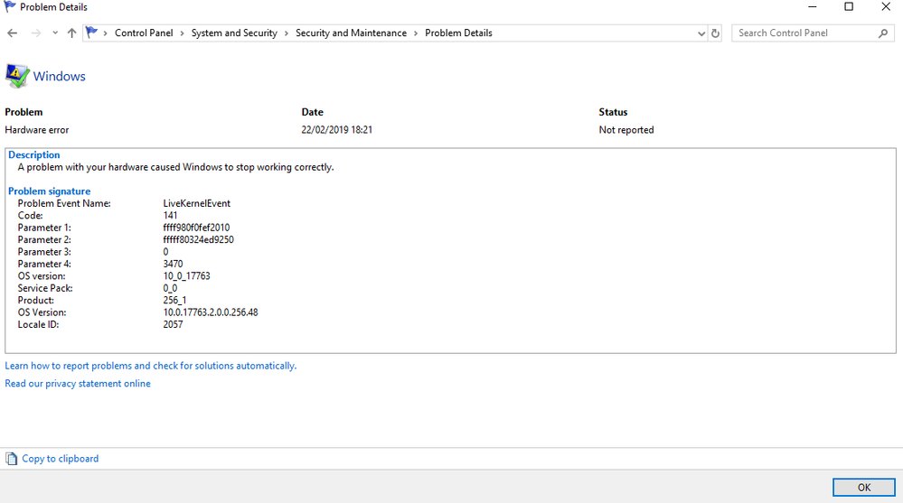

On a clean install, with latest driver, my screen goes black momentarily while using Google Chrome.
Event viewer gives the following info:
Display driver igfx stopped responding and has successfully recovered.
Event ID 4101
New drivers seem to be crashing a lot (almost daily in my case) did not have this issue with older drivers.

Another thing I have noticed, is that when i disable "contrast enhancement" in the "image enhancement" options, this gets re-enabled automatically when I restart the machine. I then have to disable it again.

Hello MJone10, Thank you for your response. I have been reviewing the information and also I have checked further into this error that you are getting and apparently it is something of a known issue with Microsoft*, there are several threads with people experiencing the same issue. Taking all this into consideration I would say it has to do with an Operating System corruption, which could be addressed re-installing it. If you do want to try this option, please check the link below and download the Media Creation Tool: https://www.microsoft.com/en-us/software-download/windows10 * Please be aware that the content on that site is not controlled by Intel*. This information is offered for your convenience and should not be viewed as an endorsement by Intel* for the merchants or services offered there. * You will need a USB Flash drive, it is recommended to fully format it before starting the process of turning it into a bootable USB drive. Once it is bootable, please use that flash drive to install the freshly downloaded Windows* image. When done with the setup and all the updates, check to see if the error persists. Regards, David V Intel Customer Support Technician Under Contract to Intel Corporation

What I have done for now is to uninstall the drivers and app, and let Windows install the Intel driver automatically.
I haven't had any issues with the driver crashing, or opening the control panel. So the issue does seem to be driver related somehow. I'm also not having the issue of any settings resetting after reboot.
