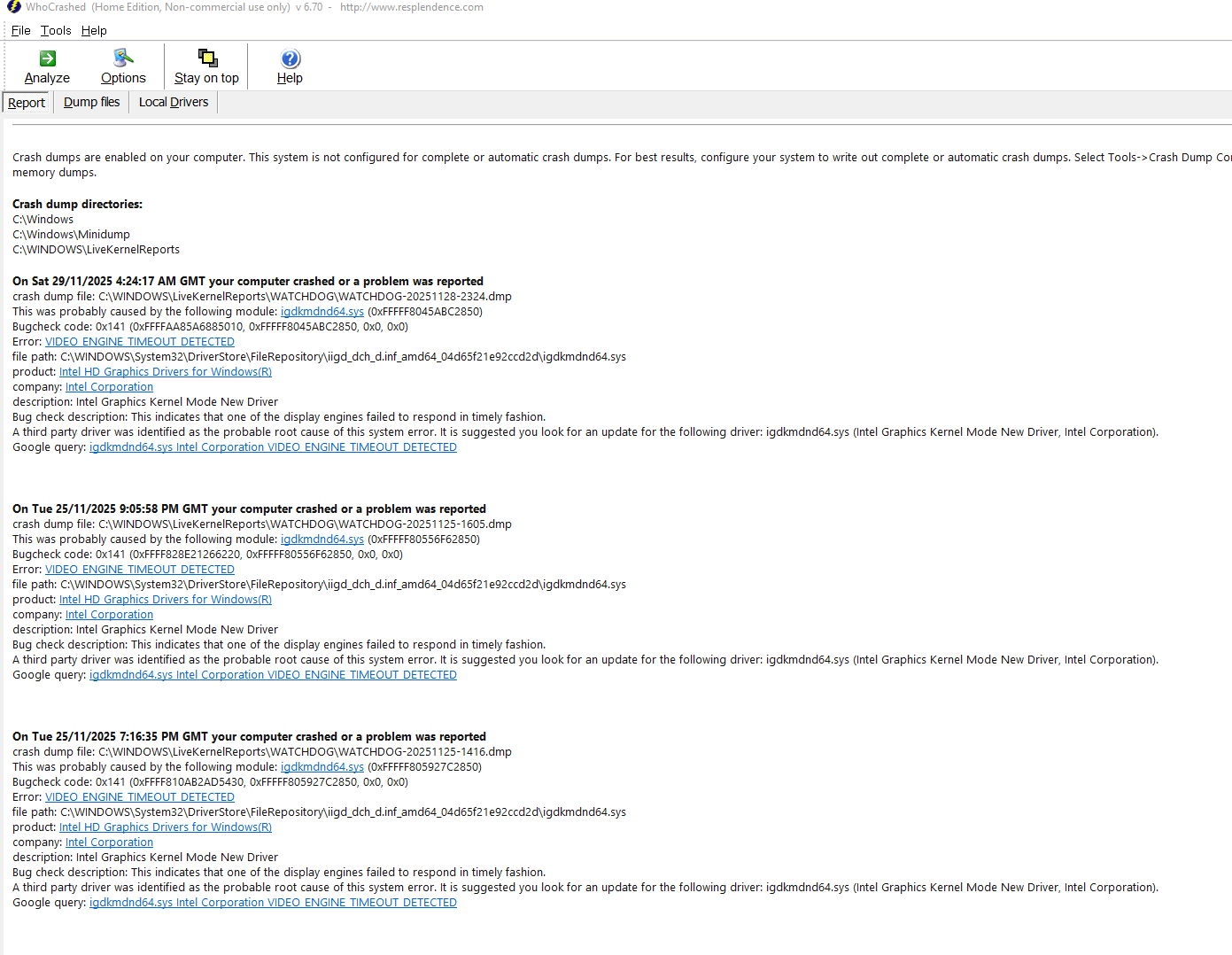

You're lucky, I was able to find some dump files. Also, look at the screenshot attached; it contains the analysis of the 3 dump files and indicates this:
On Sat 29/11/2025 4:24:17 AM GMT your computer crashed or a problem was reported
crash dump file: C:\WINDOWS\LiveKernelReports\WATCHDOG\WATCHDOG-20251128-2324.dmp
This was probably caused by the following module: igdkmdnd64.sys (0xFFFFF8045ABC2850)
Bugcheck code: 0x141 (0xFFFFAA85A6885010, 0xFFFFF8045ABC2850, 0x0, 0x0)
Error: VIDEO_ENGINE_TIMEOUT_DETECTED
file path: C:\WINDOWS\System32\DriverStore\FileRepository\iigd_dch_d.inf_amd64_04d65f21e92ccd2d\igdkmdnd64.sys
product: Intel HD Graphics Drivers for Windows(R)
company: Intel Corporation
description: Intel Graphics Kernel Mode New Driver
Bug check description: This indicates that one of the display engines failed to respond in timely fashion.
A third party driver was identified as the probable root cause of this system error. It is suggested you look for an update for the following driver: igdkmdnd64.sys (Intel Graphics Kernel Mode New Driver, Intel Corporation).
Google query: igdkmdnd64.sys Intel Corporation VIDEO_ENGINE_TIMEOUT_DETECTED
Not sure if this means anything, but it might.

Hello Gabe9000,
Thank you for sharing all this information. The logs that you shared will really help with the investigation that I'll conduct. I'll get back to you as soon as possible.
Best regards
Jed G.
Hello Gabe9000,
I am reaching out to inform you that we are actively working on this issue. Additionally, we have released a new driver version, 32.0.101.8331, which includes several fixes.
Please install the updated driver and let us know if the issue persists. Your feedback will help us proceed with further testing.
