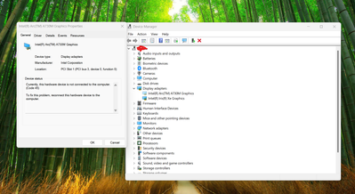

Just yesterday I tried to run valorant but it required me to update my drivers to the latest ones. After installing Intel Arc & Iris Xe Graphics 32.0.101.6559 (WHQL Certified), i was getting some disgusting frame drops.
I realized that my Intel ArcA730m graphics card was unrecognized and not being used at all. It didn’t show up in task manager, and in Device Manager after showing hidden devices I was able to see it grayed out. There was no option to enable or disable it. Then I uninstalled and reinstalled it quite a few times but that didn’t resolve my issue.

- Are there any error messages or codes in Device Manager related to the graphics card? Could you also provide screenshots of the grayed-out device in Device Manager?

Hello, thank you for the response.
1: Yes, I did.
2: Yes, the image is attached below.

Hi faan,
To address the issue regarding error code 45 in the Device Manager, you can follow these general troubleshooting steps: Error: “This Hardware Device Is Not Connected… (Code...

Hello. I just tried the steps provided after installing the latest BIOS version.
1: After setting BIOS to the optimal default using F9, and saving, the graphics card still did not start working, and remains grayed out with error code 45.
2: I browsed through the BIOS menu but could not find a graphics section. In the advanced tab I was unable to locate any setting known as onboard graphics or built in graphics.

Here is what I meant when I said that sometimes the card shows up, but crashes later. This time though it has a yellow warning sign and it does not show up in task manager.
