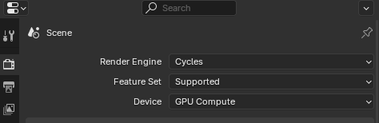

Sorry, I totally forgot the steps for Cycles, I attached a test project with Cycles+GPU compute already selected
- Cleaned up the old drivers and installed the ones for the version of Ubuntu currently running ( 25.04 ), as per the instructions
- Open Blender, either leave the default cube or open a project
- Go to Edit > Preferences > System > OneAPI, Make sure A750 is listed and checked, along with Embree.
- Go to Properties > Render/Render Properties > Make sure Render Engine = Cycles and Device = GPU compute
- Go to Render > Render Image
