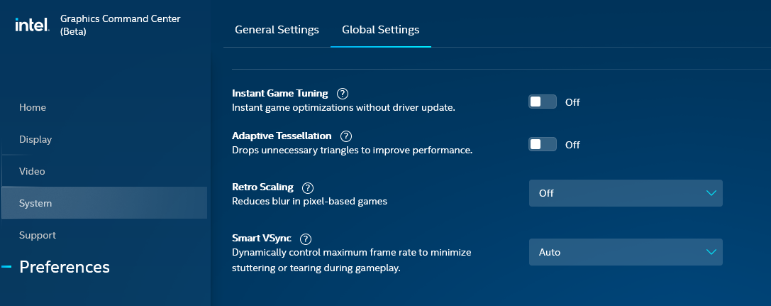

Since Arc Control and Intel Graphics Software can't initialize with this processor, please try using Intel Graphics Command Center (Beta) instead. You can download it here and follow the steps in the article below. Also, check the attached files.

Good News: I got it installed, and I managed to find the Vertical Sync option.
Bad News: It doesn't seem to be working to limit the FPS for the specific game I want to limit it for. I had to select it manually, so there's a possibility I might have done that wrong.

To assist you better, could you please let us know if you're playing the game in Fullscreen mode or Windowed mode?
Just a quick note: VSync settings only impact games or applications when they are in Fullscreen mode.

Windowed, but I'm open to trying fullscreen if it helps.
RandyT_Intel
13,779 Views
Hi @ComputerBroke,
Unfortunately, VSync settings only impact games or applications when they are in Fullscreen mode. Try to play the game in full screen mode, In older Intel® graphics drivers, this feature could be disabled for OpenGL* applications (not DirectX* games/applications). If issue persist you may have to contact your system manufacturer they might have customized certain components for compatibility.
