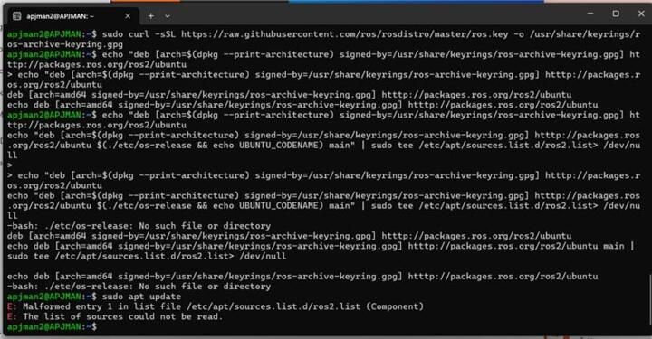

2. Set up Sources (WSL Ubuntu Terminal):
sudo apt install software-properties-common
sudo add-apt-repository universe
sudo apt update && sudo apt install curl -y
sudo curl -sSL https://raw.githubusercontent.com/ros/rosdistro/master/ros.key -o /usr/share/keyrings/ros-archive-keyring.gpg
echo "deb [arch=$(dpkg --print-architecture) signed-by=/usr/share/keyrings/ros-archive-keyring.gpg] http://packages.ros.org/ros2/ubuntu $(. /etc/os-release && echo UBUNTU_CODENAME) main" | sudo tee /etc/apt/sources.list.d/ros2.list > /dev/null

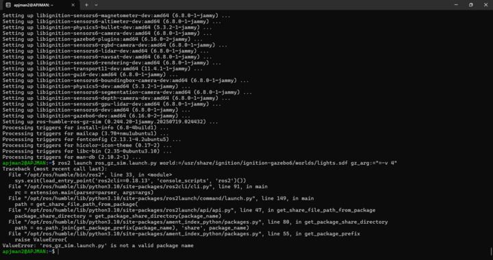

6. Test the Installation (Example, leading to crash):
ros2 launch ros_gz_sim gz_sim.launch.py world:=/usr/share/ignition/ignition-gazebo6/worlds/lights.sdf gz_args:="-v 4"
This is the command that consistently leads to the LLVM error and crash.

I just want to update you that we've tried the commands provided by the customer. We are getting the following malformed error message:
Upon checking, the command was correctly recorded by was encountering errors:
To work around this issue, I tried using the official documentation and have successfully installed humble hawksbill - https://docs.ros.org/en/humble/Installation/Ubuntu-Install-Debs.html
I was also able to install and follow the command to install Ignition Gazebo 6.16 that you left.
Afterwards, I tried the command that you mentioned and encountered another error message.
Please confirm if the steps we've followed is correct or if there are other possible ways to initiate the software for us the check the issue in our lab.

1. Regarding the Malformed entry 1 in list file error:
The Malformed entry 1 in list file error you received is likely because the $(. /etc/os-release && echo UBUNTU_CODENAME) part of the echo command was not correctly parsed, or there was an issue when executing it as part of a multi-line command.
To resolve this, I recommend using the following more robust, step-by-step commands to add the ROS 2 sources list:
(Command line instructions:)
# First, execute this command to ensure UBUNTU_CODENAME is correctly resolved
UBUNTU_CODENAME=$(. /etc/os-release && echo UBUNTU_CODENAME)
echo "deb [arch=$(dpkg --print-architecture) signed-by=/usr/share/keyrings/ros-archive-keyring.gpg] http://packages.ros.org/ros2/ubuntu ${UBUNTU_CODENAME} main" | sudo tee /etc/apt/sources.list.d/ros2.list > /dev/null
# Alternatively, you can manually add the following line to the /etc/apt/sources.list.d/ros2.list file:
# deb [arch=amd64 signed-by=/usr/share/keyrings/ros-archive-keyring.gpg] http://packages.ros.org/ros2/ubuntu jammy main
# You can also use a text editor like nano or vim to manually add it:
# sudo nano /etc/apt/sources.list.d/ros2.list
2. Regarding the ValueError for gz_sim.launch.py:
The ValueError: 'ros2 launch' is not a valid package name or file path error you saw typically occurs when the ROS 2 environment script (/opt/ros/humble/setup.bash) has not been sourced. This prevents the system from recognizing the ros2 command.
Before running any ros2 command, please ensure you execute the following command in the terminal to load the ROS 2 environment:
source /opt/ros/humble/setup.bash
export ROS_APT_SOURCE_VERSION=$(curl -s https://api.github.com/repos/ros-infrastructure/ros-apt-source/releases/latest | grep -F "tag_name" | awk -F\" '{print $4}')
curl -L -o /tmp/ros2-apt-source.deb "https://github.com/ros-infrastructure/ros-apt-source/releases/download/${ROS_APT_SOURCE_VERSION}/ros2-apt-source_${ROS_APT_SOURCE_VERSION}.$(. /etc/os-release && echo $VERSION_CODENAME)_all.deb" # If using Ubuntu derivates use $UBUNTU_CODENAME
sudo dpkg -i /tmp/ros2-apt-source.deb
sudo apt update
sudo apt upgrade
sudo apt install ros-humble-desktop
sudo apt install ros-humble-ros-base
sudo apt install ros-dev-tools
# stop copy + pasting here
Install Ignition Gazebo 6 using the following command:
sudo apt install ros-humble-ros-gz-sim -y
Once done type in and execute the following command:
Close out the Gazebo quick start window
Close the Ubuntu terminal
Open new ubuntu terminal
follow the installation instructions for Ubuntu 22.04
Input the following commands:
# start copy + pasting here
wget -qO - https://repositories.intel.com/gpu/intel-graphics.key | \
 sudo gpg --yes --dearmor --output /usr/share/keyrings/intel-graphics.gpg
echo "deb [arch=amd64,i386 signed-by=/usr/share/keyrings/intel-graphics.gpg] https://repositories.intel.com/gpu/ubuntu jammy unified" | \
 sudo tee /etc/apt/sources.list.d/intel-gpu-jammy.list
sudo apt update
sudo apt-get install -y libze-intel-gpu1 libze1 intel-opencl-icd clinfo
sudo apt-get install -y libze-dev intel-ocloc
sudo apt-get install -y intel-level-zero-gpu-raytracing
# end copy + pasting here
Verify the graphics installation by copy+pasting and executing the command below:
clinfo | grep "Device Name"
Attempt to start Gazebo again:
Please try the steps above and update me if the issue still persists after following the steps.
