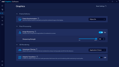

1. I started to act like this after certain update of intel graphics driver software update. Before I use to use GPU Scaling(Preserve Aspect Ratio) use to fill the whole display. Now none of GPU scaling method works not even Stretch to fill whole screen. I have latest WHQL Driver software update of 5/30/2025 where it also works as given in above screenshot i.e. on Stretch Scaling method of GPU scaling mode. I also tried Life is Strange, Life Is Strange: True Colors there Stretch scaling also not work. But when I tried Persona 4 Golden where even 800x600 resolution streches to whole screen using same scaling settings i.e. there i does not occur.
2. Setting of my IGS are as follows in the following screenshots:
- Updates manual and automatic updates disabled, Install mode express. Current Driver version 32.0.101.6874
- My laptop is HP 15.6 inch Laptop PC 15-d5000. It shows as HP Laptop 15s-fq5xxx in Intel SSU.

I have just used latest WHQL driver version 32.0.101.6881 . It has largely fixed my problem now when I set GPU scaling to Stretch and Centered then my desktop screen also adjusts entirely eg. switching to resolution such as 720p. When I switch to lower resolution then when I select Stretch it stretches to whole screen and when I select centered it centres to the screen i.e. black bars on all sides i.e. It works as expected.
I don't know how this update of generic driver has worked. But also tried on some other apps at lower resolution it worked flawlessly.
