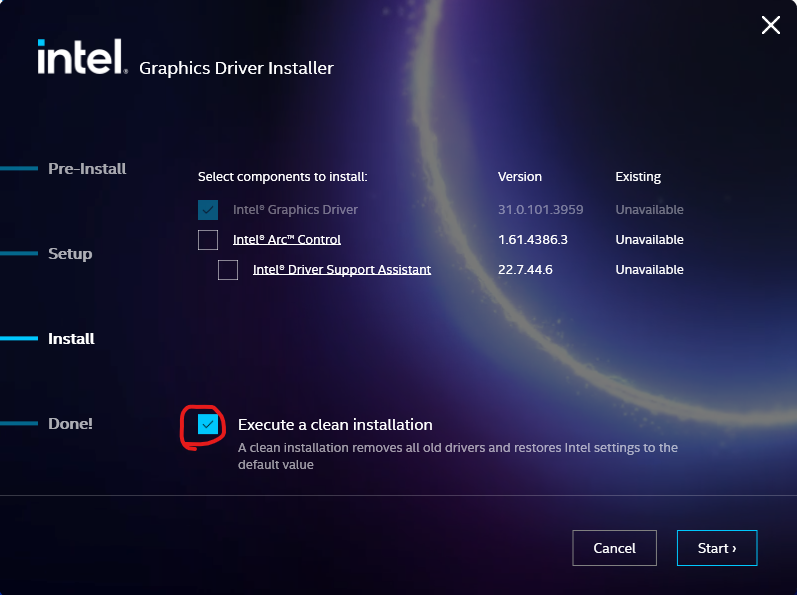

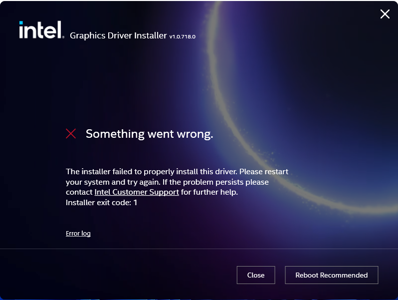

Hi Andres,
I have encountered the following problems when updating the driver.
If this option is not checked, it seems that the driver has been updated successfully and there is no error message.
