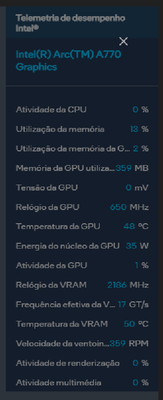

Intel Arc Control app stopped working properly after installation of driver on January 8th
The overlay won’t appear and I not able to click with mouse anything.
Alt+O shows telemetry overlay but without any activity.
After press Alt+I I can use the mouse again.
Uninstall and clean install of arc control app and drivers (versions 101.3678 from asus site, 101.4032, 101.034) and the behaviors is similar.
Also try to uninstall several apps from Asus, Canon, Adobe but no success.
The only thing I hadn’t done is a clean installation of windows.
Every time I open Intel Arc Control – windows reliability monitor records the same error on ArcControlAssist.exe (record attached).
Attached ssu scan, could someone assist?

Solved and additional information:
It seems related with audio issue related with Asus Utility audio control
  • Deactivated the device “Asus Utility” on device manager and the IAC worked
another test was:
  • Kept “ASUS Utility” activated on device manager
  • Plugged a microphone (made 2 tests separately – one mic from a camera and another mic from a field recorder) and IAC worked
My conclusion – need to have plugged a microphone to be able to work with IAC while ASUS Utility is activated.

  1. on device manager how do you turn off the Asus utility?
On device manager  "Gestor de Dispositivos" on sound controls "Controladores de som, video e jogos" just deactivate de device - see below picture :
2. Which camera software and field recorder software do you activate the mic on for?
I don't activate any software, just plugged the camera (Logitech C922) and windows 11 installed the drivers.
For the field record (ZOOM Audio F1 ) had installed the Zoom Drivers before connect the record via USB.
Another thing I had done and not mentioned is that I just plugged a simple mic to the 3.5 mic jack on the motherboard and IAC works as well.
Image below, shows on device manager the camera and the field record connected.
From my point of view, IAC needs some mic to work – if there is no mic, the IAC freezes.
Antonio

I just bought an A770 16GB Limited Edition and I am running into the same issue as other people in this thread, however I do not have anything Asus in Device Manager that I can try disabling. I also do no have a microphone I can try plugging in. I have however tried disabling my wireless headset earphone and microphone in device manager, as well as my LG C2 TV. None of that made any difference.
When I press Alt+O as I saw someone suggest, the telemetry does show up, though it is completely empty:
I've used DDU in Safe Mode before installing the Intel drivers. So far the only other thing I have done is tried to Repair the driver installation.
