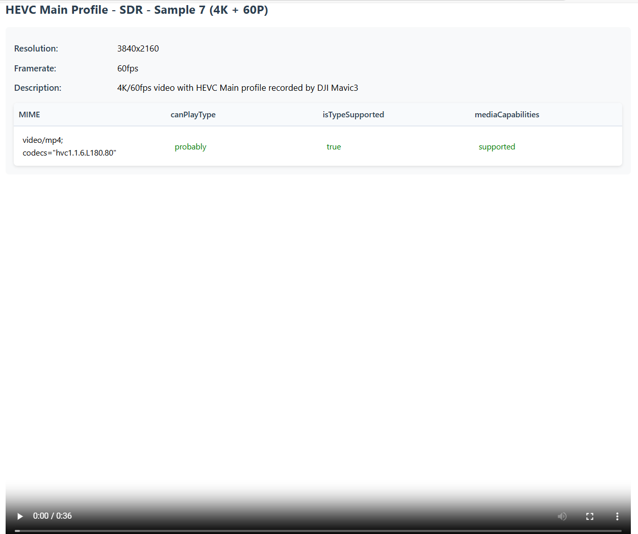

cuspis
30,704 Views
  • When playing any video from any device — GoPro, Insta360, DJI, mobile phone, or in a web browser — the video does not use the GPU!
    In all these cases different bitrate, color depth, and frame rate settings are used...
  • When playing videos in third-party players such as VLC, PotPlayer or Windows Media Player Classic — the issue remains
  • I will not install K-Lite Codec Pack (for personal reasons)
