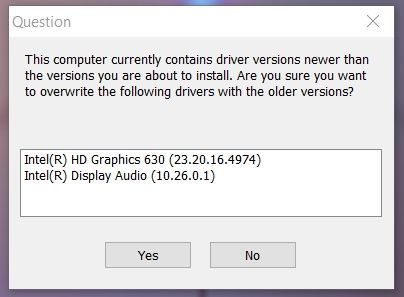

When I download and try set up -- it activates that 'install anyway from the web thing' , which I get, but it always does it TWICE. As if I clicked set up TWICE. The 2nd time 'round it shows me THIS --
I stop here because I don't wish to downgrade. Right?

Thanks. I tried that install and got an error indicating the driver wasn't suited for my unit. That I should go through Asus.
I just noticed something odd. If you scroll up you see Asus offering me a driver version starting with a 24. However, in Device Manager, my current one starts with a 23.
How, therefore, can it be telling me I have a later version installed when apparently I do not?
AlHill
4,206 Views
Well, it is correct that you should go through Asus, as the graphics driver they provide may have been modified/customized for their hardware.
Download and save the EXE version on that page.
Then, follow my procedure here: https://forums.intel.com/s/question/0D50P00004Fm2ngSAB/how-to-install-the-dch-driver?language=en_US

Okay. It's (maybe) fixed? Let me explain what happened.
I followed your instructions. However, the system wouldn't allow me to manually install the 24. driver without access to 'Smartscreen' from Windows Defender. When I got around that I got some message saying indicating it didn't want the update. (Forgot what it said.)
Left with no choice I rebooted. When I did it installed the current Intel 25. driver. Soon thereafter the Intel Graphics Settings icon appeared in the system tray. Goal achieved.
In Device Manager, in a twisted moment of curiosity, I asked it to update the driver. To make sure I was using the most recent version of the 25. driver. It downgraded me back to a 23. driver and removed the Intel Graphics settings icon in the system tray. Sigh.
So I repeated the steps to get back up to the 25. driver and have stopped fussing with it.
So THANKS because at least my goal was achieved. (Is using Intel's driver instead of the Asus one bad?)
