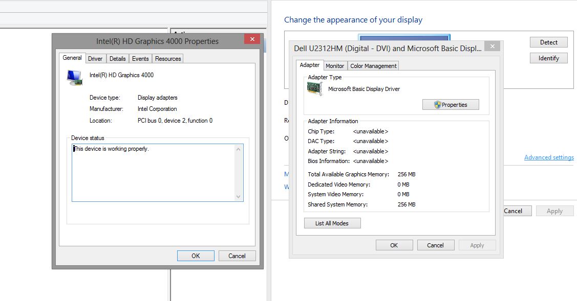

Hi all,
Would you please post a screenshot of Device Manager showing the adapter that appears under Display Adapters and another screenshot of the Display Control Panel?

Hi genericasian,
Checking the pictures seems to be a corruption in the registry but, still you can post the Dxdiag report and if possible the Graphics Diagnostic Report to see if there is anything else that can be done.
You can create the Dxdiag report if you click on the Start button, type in "dxdiag" on the search bar, press enter, click on "Save All Information" and please post here the report.
This link will help you generate the Graphics Diagnostic Report http://www.intel.com/support/graphics/sb/cs-009476.htm http://www.intel.com/support/graphics/sb/cs-009476.htm. Due to the issue you are having you may not be able to create the Graphics Diagnostic Report, there is a chance you will not be able to find all of the options.

Here you are. Your "alternate" steps won't work for me because I don't have access to the Intel control panel. I don't believe the computer thinks that there is an Intel graphics device is present; every time I try to launch it, nothing happens.

Manufacturer:
Chip type:
DAC type:
Device Type: Display-Only Device
Device Key: Enum\ROOT\BASICDISPLAY
Display Memory:
Dedicated Memory: n/a
Shared Memory: n/a
Current Mode: 1920 x 1200 (32 bit) (64Hz)
Monitor Name: SyncMaster T240,SyncMaster Magic T240(Digital)
Monitor Model:
Monitor Id:
Native Mode:
Output Type:
Driver Name:
Driver File Version: ()
Driver Version:
DDI Version:
Feature Levels:
Driver Model: WDDM 1.2
Graphics Preemption: DMA
Compute Preemption: DMA
Driver Attributes: Final Retail
Driver Date/Size: , 0 bytes
WHQL Logo'd: n/a
WHQL Date Stamp: n/a
Device Identifier:
Vendor ID:
Device ID:
SubSys ID:
Revision ID:
Driver Strong Name: basicdisplay.inf:1080904755d1bda1:MSBDD_Fallback:6.2.9200.16384:ROOT\BasicDisplay
Rank Of Driver: 00FB0000
Video Accel:
DXVA2 Modes:
Deinterlace Caps: n/a
D3D9 Overlay:
DXVA-HD:
DDraw Status: Disabled
D3D Status: Not Available
AGP Status: Not Available

Thanks for the information ALI/genericasian. I'm waiting on a response from Zac, and anyone else who encounters this problem - please provide the same information!
I'll let you guys know when I have an update on this issue.
-Nic

Hi everyone,
So I worked with the folks at Gigabyte* yesterday to see if they could reproduce the problem with their own hardware. They tested ALI's configuration (same motherboard, same processor), with all 3 drivers - and were unable to show the problem. I've attached the screenshots they provided. You'll notice how through all 3 drivers they tested (ours, theirs, and microsoft*) - the adapter information was still visible.
Since they were unable to reproduce the same problem, I would recommend exchanging your motherboard for a new one. Let me know if you have any other questions/comments/concerns.
-Nic

Hi Nic,
I Have already replaced my motherboard once the Gigabyte UP5-TH and I don't think its a hardware problem. The only solution I found is to do a fresh installation of Windows 8.
