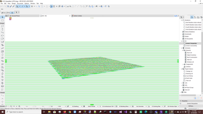

Intel HD 630 green lines in OpenGL apps
Asylum
10,773 Views

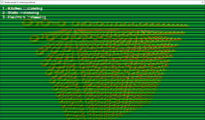

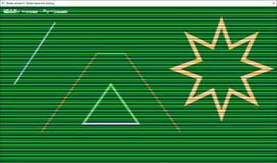

Happens only with OpenGL (Vulkan/D3D is fine) since around the June driver.
System information: https://www.dropbox.com/s/ntl0pgmzfigkjgt/asylum-pc.nfo?dl=0
Simple test code: https://www.dropbox.com/s/83s85i9m30efs7z/51_ShaderBasedLineAA.zip?dl=0
More samples: https://github.com/asylum2010/Asylum_Tutorials

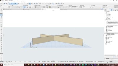

sorry for the late reply (I use the integrated card for debug purposes only).
I can confirm, that ArchiCAD and most of my samples work fine with the above mentioned beta driver.
I would say that this issue can be closed.
