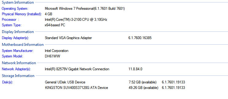

I work in an educational institution,
and we have a lab contains 20 PCs with Intel DH61WW motherboard
Recently I cloned a new image to the computers, and after updating the motherboard drivers
the HD Graphics Driver keeps crashing the PC after updating it ... I really would like some help in this issue

Hi Saeed92,
Since this motherboard is a legacy product let me see what I could do for you.
Could you please attach the result of the Intel® System Support Utility?
https://downloadcenter.intel.com/download/25293/Intel-System-Support-Utility https://downloadcenter.intel.com/download/25293/Intel-System-Support-Utility

Hello Hellen,
Thank you for your reply
Here's the result from SSU
Saeed

Hi Saeed92,
I couldn't check the correct Graphics driver you are using, regards that let's try installing this version which is the latest version for your Intel® HD Graphics 2000 controller:
https://downloadcenter.intel.com/download/24970/Intel-HD-Graphics-Driver-for-Windows-7-8-8-1-32bit https://downloadcenter.intel.com/download/24970/Intel-HD-Graphics-Driver-for-Windows-7-8-8-1-32bit
Hellen.
