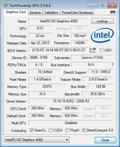

also can I have your GPU-Z screenshot? just wanted to make sure my HD 4000 isn't the gimped version which have lower ROPs/TMUs and fillrate
http://gpuz.techpowerup.com/15/08/30/53.png http://gpuz.techpowerup.com/15/08/30/53.png
Looks like your iGPU is ok, not crippled or anything. 16 Execution Units, 4 ROP, 8TMU right? I narrowed down my iGPU problems to the RAM after switching machines to an e6430. I hope to replace the bad RAM and OC my iGPU up to 1600-1700MHz using UEFI variables. Maybe you could do that as well?
