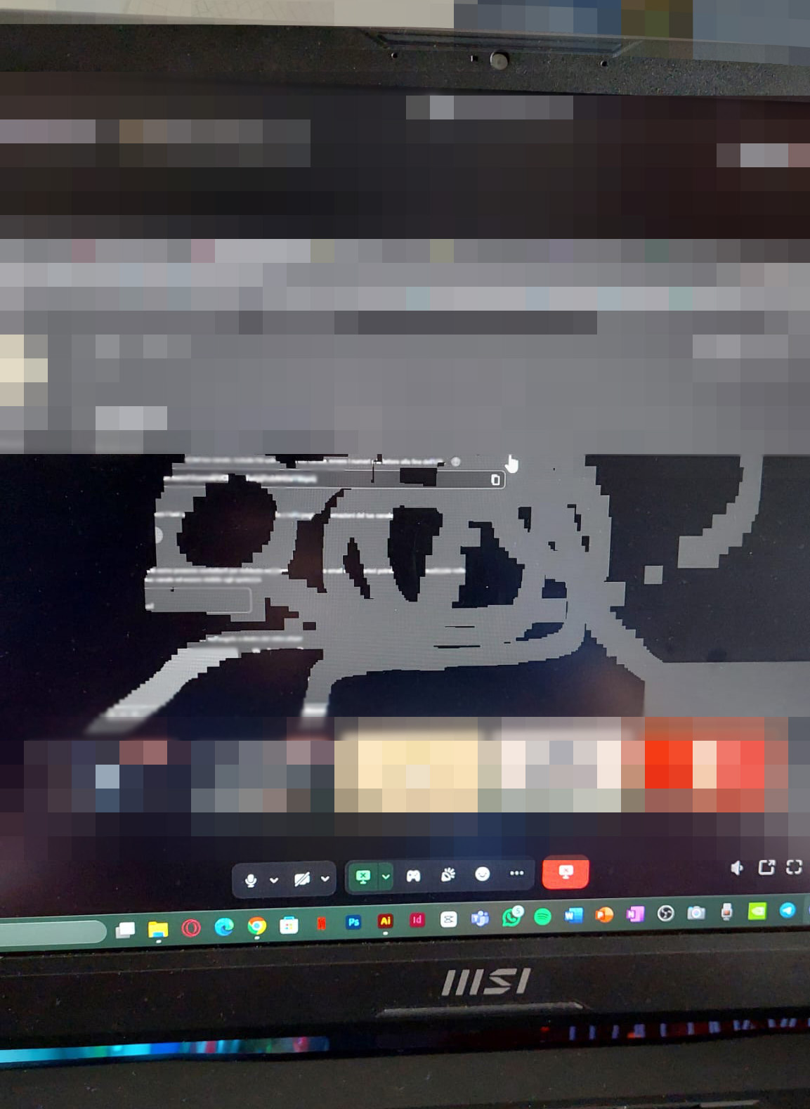

Good afternoon, I'm having some problems updating the Intel drivers for my graphics card, some time ago I discovered that the generic Intel drivers for my notebook (MSI GL76 Pulse) are not good. Updating from the Intel app, the computer screen starts to flicker, forcing me to use obsolete drivers. The Nvidia drivers for my RTX 3060 are constantly updated and I don't understand what the problem is.
During daily use, so not only with graphics programs (Adobe Suite that I use frequently) the computer starts to have real glitches on the screen, but not only that, it suffers real slowdowns, lack of fluidity in opening some apps like the Nvidia one. I attach some screenshots of the problems I'm talking about.
I hope there is a solution to all this, I wouldn't like to have to change my computer because of conflicts between drivers, unsolvable, or the inactivity of the Intel graphics card due to updates that I can't do, thanks in advance.
I await your news

The update of driver may be the cause as it was not updated properly. I think it best if you could conduct a clean installation. You can either use the driver from your laptop website or in the intel website. Either way it is fine, then follow these steps on this link https://www.intel.com/content/www/us/en/support/articles/000057389/graphics.html
Just make sure that your internet is disconnected intor your laptop so that it won't automatically install back once you manually uninstall it

I followed all the steps and the flickering still occurred, now I'm trying with the DDU as the guide reports.

It has now finished rebooting and the flickering is still present, but not in safe mode, so I'm assuming the Intel drivers are the problem(?).
What I notice is strange is that when I open the Intel Graphics Software screen, the flickering is not present, but if I close the window, it starts to flicker. What can I do? The drivers on the MSI website in the Graphics section are from 2022, aren't they a bit out of date if I wanted to try those too? I look forward to hearing from you.

Could you try disabling the integrated GPU to test if the issue will still occur even if your laptop is using the dedicated GPU which is the Nvidia

If I disable Intel the flickering disappears, obviously the computer is more jerky but it does not flicker, so the problem is the integrated

That isolates it, try using the driver from msi just for testing if the issue will went away I guess the issue will be the compatibility of the latest driver from intel and your laptop.
If I am not wrong, oem laptops have customize or changed their driver to better suited on their system requirements and specification

I installed the drivers from the MSI website, it is an older version (2022-12-12 is the latest release found on the website for my PC) but at least the flickering is not present, the problems related to fluidity unfortunately persist
