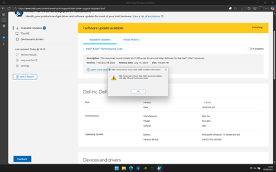

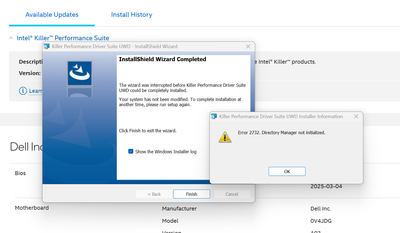

Hello qTheo,

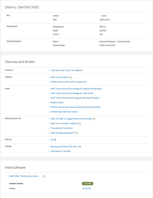

I appreciate you for sharing a photo of what's happening. To help you effectively, please share the information below.
1. Were you able to use Intel Killer Performance Suite along with the Integrated and discrete graphics before?
2. Do you remember if this issue happened after a new OS update or Wireless driver update?
3. Is this the original adapter that came pre-installed in your system, or have you changed/installed a new adapter recently?
Additionally, to have a better understanding of your system configuration and components please generate System Support Utility (SSU) report. Please follow instructions here and send the report - How to get the Intel® System Support Utility Logs on Windows*
Best regards
Jed G.

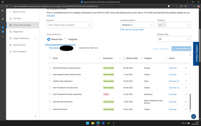

1. I had a version from DELL site which worked fine with both GPUs, but now it seem is not working anymore, im not sure if DELL changed the driver version or is it becouse i installed more drivers for intel from DELL SITE.
These are some drivers I started to download -
thre are more drivers just couldnt fit all of them in the picture at once also i installed everything with intel on it from dell site.
But i had installed all of them a few times and i didnt have the problem before (very long ago), and im very confident the problems started since i started to use INTEL DRIVER/SUPPORT site.
2. only started after using the INTEL DRIVER/SUPPORT website, also could be from something else as i done a fresh window install when i first used the INTEL DRIVER/SUPPORT app/website.
3. Never changed anything.
