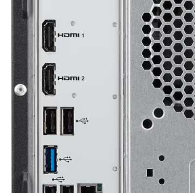

Hey
I use 2 Samsung LS27A600U monitors. But in settings a can just 1 monitor set to 75Hz. The one who is connected to HDMI 1 at PC. The other monitor (connected to HDMI 1) max 60Hz
Sam monitors. Same cables. Same settings.
Intel Arc Control 32.0.101.6078 (13.09.2024)
Any ideas what can be wrong? Thank you!

Hi
Thank you for your effort. But unfortunately this answer is not helpful.
UHD 770 - no 2 DisplayPort - my monitors also not.
HDMI cable is 2.1
One HDMI output of the graphics card can be operated at 75Hz. Only the second HDMI output only works up to 60Hz. That is the question why this is the case.

So you connect here?
According to the manual, the following applies to the Samsung monitors:
- Resolution: 2560 x 1440
- Refresh rate: 75 Hz / 60 Hz
- Pixel clock: 304.3 / 241.5 MHz
This leads me to believe that only one of the two HDMI ports corresponds to version 2.0. The integrated graphics can only work up to 300 MHz pixel clock in the HDMI 1.4 version. Therefore, I suspect that HDMI port #2 is only version 1.4.
Unfortunately, there is nothing that can be done about this. If you want to know exactly, you would have to ask Acer Support, because the inner workings of this PC, including the HDMI ports, were designed by Acer.
