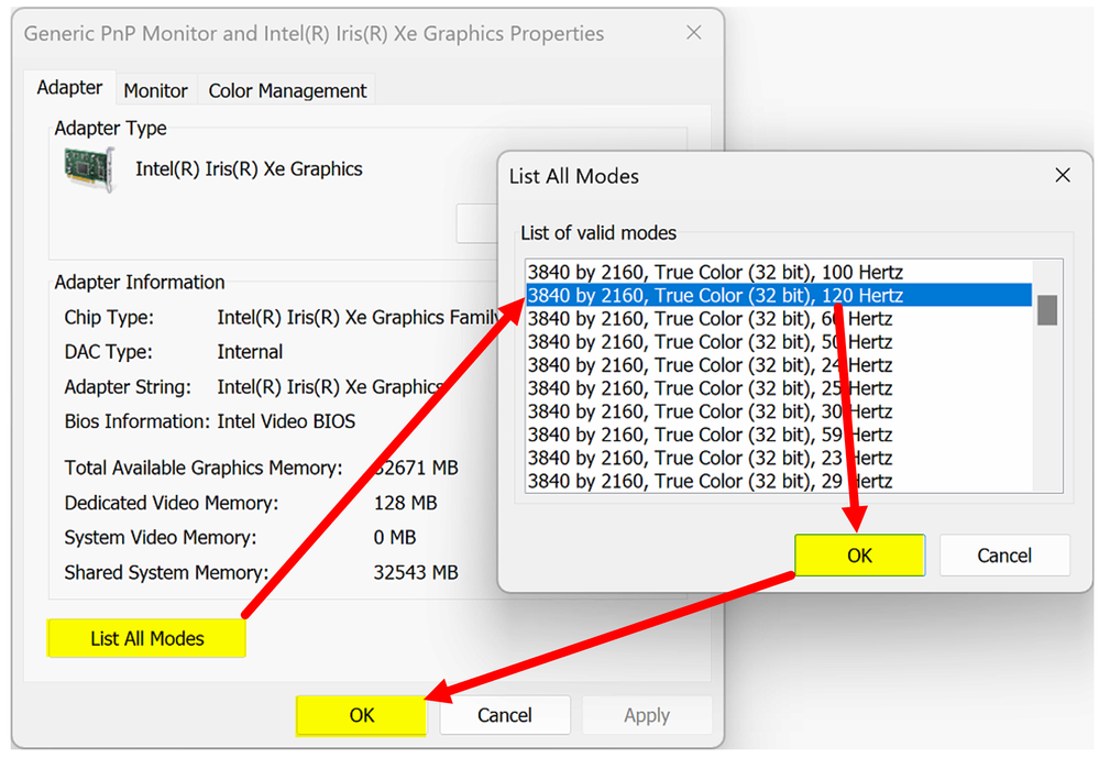

Ok the cable finally arrived and it looks great. 4K, HDR is recognized in Windows 11, I can go upto 120 Hz, just like the TV supporrts. Great! 😄
Now, this Active Signal Mode, how do I change it? Seems like my PC isn't outputting on 4K yet, yet the display now is .
But without a PC which is actively signalling in 4K, it's not done yet!
Thanks a ton btw, updating a firmware for a driver is new territory for me. Thanks for getting me 1 step further
MUC
Honored Contributor I
33,800 Views
Please try as follows:
  1. Click the Display adapter properties link shown in your picture above. If you use more than one display, select your TV from a drop-down list at the top of the window.
  2. The system will open a window with your GPU properties from the classic Control Panel. Click the List All Modes button.
  3. Select desired resolution in the next dialog. Note that Windows lists a single resolution several times with different refresh rates. Make sure you pick the right one.
  4. Click OK to save your changes.
  5. Click OK to leave the property window.
If changes don’t take effect, then it may be useful to repeat the steps above using another resolution and then again repeat the steps reverting back to 3840 x 2160 @ 120 Hz to “synchronize” the Desktop Mode with the Active Signal Mode.

WSpamW
33,650 Views
Thanks guys, it kind of works. It's a bit flaky, sometimes the PC forgets about it and I need to adjust the settings again.
Not super userfriendly that way but maybe I'm asking too much. Pretty happy overall
