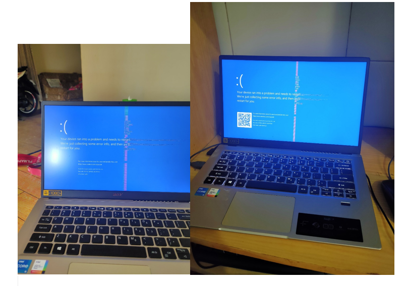

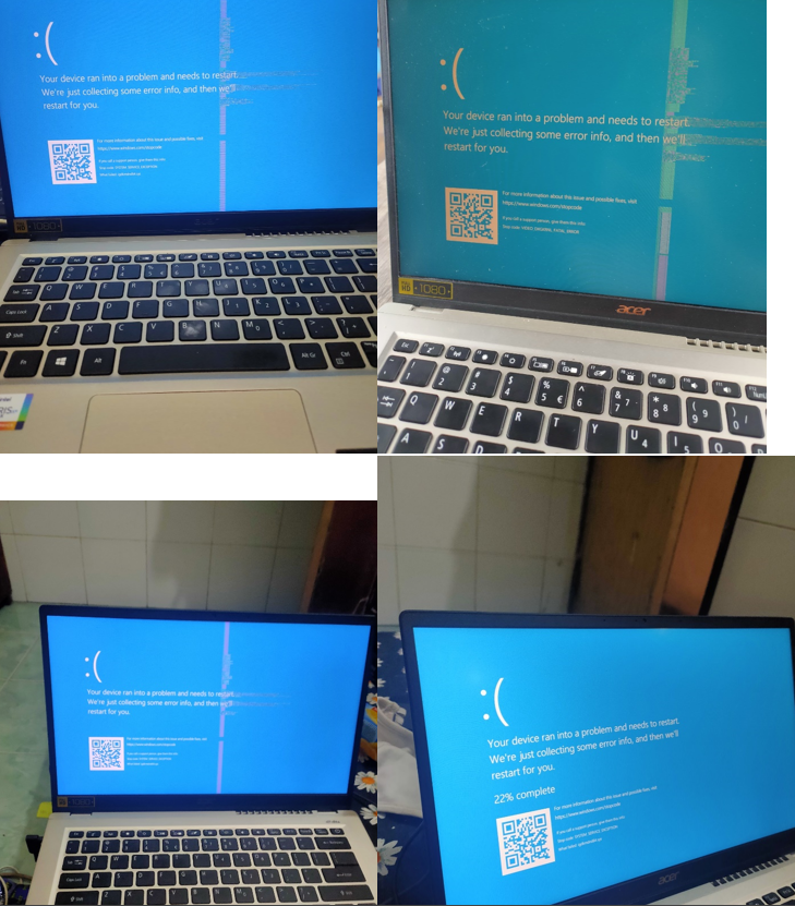

Hi, Intel I have numerous issue on my laptop and this is the worst beside the GPU that suddenly make any games crashed. I got BSOD every single day and it shows SYSTEM_SERVICE_EXCEPTION igdkmnd64.sys, I have installed many drivers, both OEM and from the Acer but no luck. This is insane considering this is a new laptop. I hope this DG1 XE and 11th gen are not a prototype product.
Additionally, When I plug in my external HDD with USB 3.0, the wifi will suddenly turned off and unable to detect any wifi around even the closest router. Please fix this ASAP because I begin loosing faith on the WIFI 6 certificiation.

Just reporting that the Feb XE/XE MAX drivers released this month do NOT resolve this issue.
I can stick with the stock ACER video drivers from August 2020, as has been reported in other threads, to prevent BSODs but (a) performance is clearly worse (FPS in games), (b) still crashing anyway (not BSOD).
Please see reports as requested to aid with your diagnosis and resolution of this. This seems to be affecting another XE MAX laptop similarly (Dell Inspiron 7506) - see link in reports to (1) Acer Swift 3x 14'' i5-1135G7/8/512SSD Laptop: $798 C&C /+ Delivery @ Harvey Norman ($798 Delivered @ Amazon AU) - OzBargain.
I understand XE/XE MAX is relatively new and low volume, and the concept is great, but this is not a great start to Intel dGPUs. I'd love to wave the flag for this product but it is currently impossible to do so.
I look forward to your response/next driver release.
Kind regards,
LF
I think I might've stumbled across something of a "solution" for people still experiencing crashing in-game with stock ACER video drivers.
For running games RIGHT NOW on the Swift 3X, DO NOT run an external display via USB C.
With USB C external display connected, the left hand deck was hot++, despite using cooling pad and XE MAX temps supposedly not getting above 60ish degrees.
Just now, on a whim, tried pulling out the USB connector, and (a) deck much less hot, and (b) no crashing out on limited testing so far (with stock ACER video drivers).
Perhaps running a high intensity task on XE MAX plus low intensity on XE (second display) just doesn't work out at this point in the driver evolution
