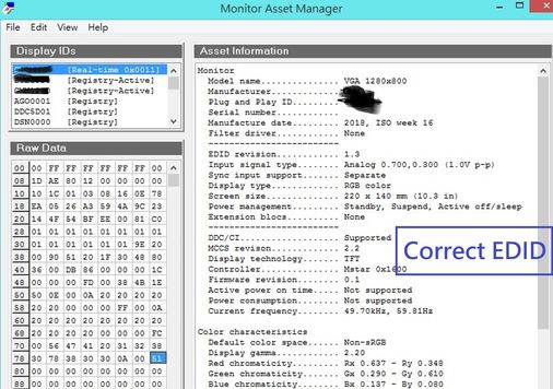

When I plug a VGA cable with A monitor (1920x800), it can't read correct EDID with moninfo.
I have check registry, it seems not correct.
Q1.How can I read correct EDID from EEPROM not registry or how registry can record correct EDID from EEPROM.
Description2
Then I changed the A monitor to B monitor(1920x1080), it still keep to A monitor (1920x800),
 status and can't adjust the resolution , 1920x1080 doesn't shown in list and  just keep 1920x800.
Description3
I found no matter I connect which monitor , it can't re-detect till I restart PC, so maybe it keep
last status.
Q2.How can I set to let PC can re-detect monitor when I connect a monitor every time.
PS. DVI and  HDMI  work normal and can read correct EDID.
I change other OS PC (windows/8/10 with intel 620) and no problem.
Thank you a lot.

1- When you said "can't read correct EDID with moninfo", do you mean you are using the tool "Monitor Asset Manager 2.9"? Is this correct?
If not, could you please confirm the exact name and version of the tool you are using? You may also share a link as a reference?
Ans : Yes , I used Monitor Asset Manager 2.9.
2- When you said "I have check registry, it seems not correct.". What exactly do you mean by "seems not correct?
What is "not correct"? What is the exact problem/behavior that this is causing? Please provide more details.
Ans:The registry was same Monitor Asset Manager 2.9 read, but not correct. So I don't sure how registry was written from EEPROM or other.
3- Why are you trying to read EDID from the monitor? Is this to review some information/capabilities, to debug an issue, or for development purposes (hardware or software)?
Ans : I want to use this PC with Monitor Asset Manager 2.9 to test our AD/B and check the EDID was correct or not.
4- Maker and model of both monitors:
Ans : We are a  AD/B design company. The monitor's AD/B was our product. I try same condition with 2~3 different PCs, but only this PC (Win 11 with 630 graphics) has problem. In this Win11 PC , the DVI & HDMI source was no problem when you connect  DVI/HDMI cable to monitor you can see the PC detect new one every time but VGA source can't, it just only detect 1 time in first power on PC and always keep this monitor's status till you re-start PC.
PS. No matter the AD/B we designed or customer designed were same result, but other PCs
       (Win10+graphic 620, Win8+graphic 4600) were no problem.
5- When you said "Then I changed the A monitor to B monitor(1920x1080), it still keeps to A monitor (1280x800) status and can't adjust the resolution, 1920x1080 doesn't show in list and just keep 1280x800"
Is "monitor B" also connected via VGA cable? Where are you trying to set resolution 1920x1080 for "monitor B"? Is it on the Intel® Graphics Command Center Display settings? Or is it on Windows* Display settings?
Ans: Only VGA has problem ,DVI & HDMI was OK. Intel Intel® Graphics Command Center Display settings & Windows* Display settings are same result.
I enclosed some photos for explain to you .
1.Connected to A monitor (1280x800)
   The EDID was not correct but the display was normal, you can compare follow 2 photos. It's same monitor but different EDID.
   2nd photo was read by other PC (Win8+graphic 4600)
2.Then connected to B monitor (1920x1080)
     Monitor Asset Manager can't be shown correct EDID, it seems empty but actually the EDID was existed.
    B monitor's correct EDID.
    You just only can see the resolution keep as monitor not B and till re-start PC.
