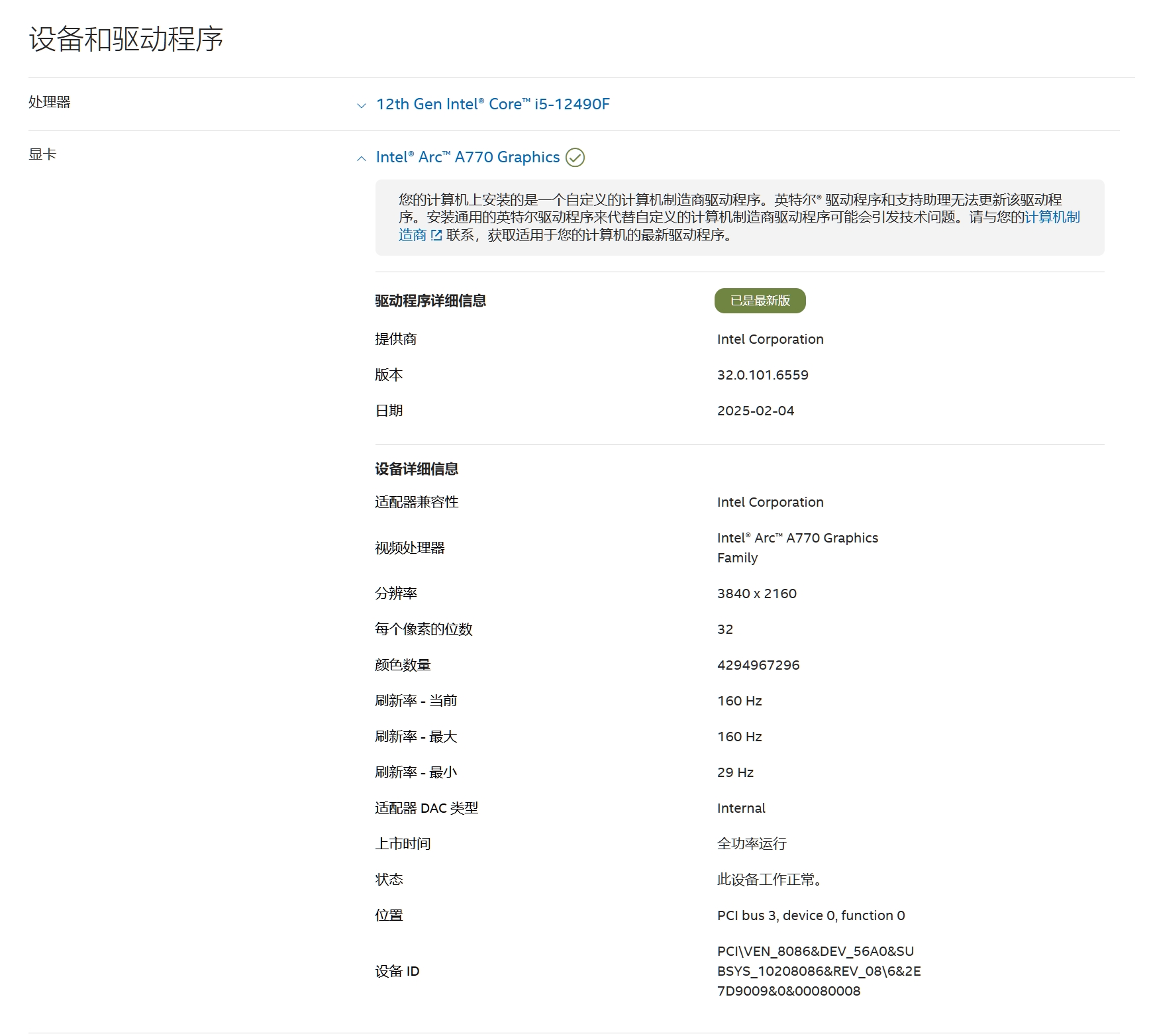

The Intel graphics software is not able to run correctly when I updated the grapphic driver. The same issue happens at the driver version from 32.0.101.6559 to 32.0.101.6460/32.0.101.6259. the software run nicely in driver 32.0.101.6458/32.0.101.6257. The issue doesn't happen again when I uninstall the driver and the software with DDU and reinstall the 6257 version driver.

It's nice to have feedback. Sorry there is no specific error codes or other alerts. The issue just happens as the following two situations:
1. The software doesn't run out the main interface. I can only see a [IntelGraphicsSoftware.Service] process in taskmer.
2. The software can run like normal but can not change any performance settings. The performance setting interface doesn't show on the program interface
3. The program run correctly only once for some reason I don't get.
It seems something wrong with the service [IntelGraphicsSoftware.Service].
For [situation 1]. It happens When I set this service as autorun in Windows Service settings. The program is set autorun with Winidows start. At that situation when I try to stop the [service] process and restart in program installation folder.  The CMD program which started by [IntelGraphicsSoftware.Service.exe] will be in a loop and fail to run.
For [situation 2]. It happens When I set the service as hand control in Windes Service settings.
For [situation 3]. It just happens for once and at that time I seems set the service as autorun and the program is autorun with start. But the next time I restart it gets back to [situation 1]
Hope this being usful.
Thanks and best regards.

Thank you for your patience VonM.
For these situation for these days. Here is what I've got. I will post some screenshots below.
For pic 1&2&3. They are for [situation 2] that I've posted before. The program only works when the service is not running and either in taskmger. And there will be some monitoring bugs due to the service's not running. And for some reason the proformance tunning is not visiable.
For pic 4. I start the service manualy. The service could be found in taskmger. And when I try to start the program it will happens exactly like the video 5.mp4 shown.
Hope this could be usful.
Best regards
Yibing

VonM_Intel
4,791 Views
Hello, yibingyibing.
I would like to inform you that the Tuning tab feature is part of our Beta testing phase, and its functionality may be improved in future updates. I recommend updating your graphics driver to the latest version to ensure you're using the most current features and improvements. Upon my testing, the Tuning tab is available in the latest graphics driver: version 32.0.101.6632. I suggest using Display Driver Uninstaller (DDU) to fully remove your existing driver before installing the latest version.
If the issue is still the same, please let me know.
Von M.

yibingyibing
4,676 Views
Hi VonM
I have updated the latest version driver 101.6632 today.
The issue seems to be fixed. I'll bring you feedback if anything goes wrong.
Thanks for your help
Best regards
Yibing
