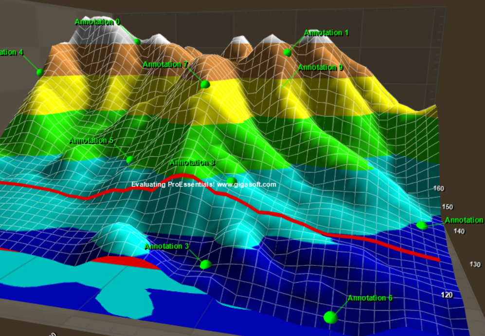

I would like to remind Intel we and thousands of our 3rd party customers, and hundreds of thousands of 4th party customers are still waiting (2+ years now) for fixes related to Intel Iris Xe problems bugs shortcomings...
1) .NET WPF component Direct3D rendering with MSAA > 1 causes the app to crash.
2) Line Topology with MSAA > 1 does not honor anti aliasing and the image looks corrupted.
3) The driver does not support double precision float variables within shaders which causes rendering corruption in cases where double precision is necessary.

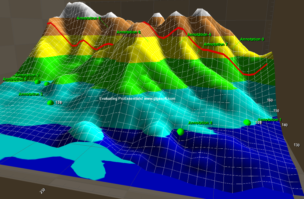

Below are example rendering with Iris Xe latest driver 5/31/23 and MS Basic Driver.  As one can see, the Iris Xe rendering is not acceptable where as the MS Basic rendering is high quality as expected.
Iris Xe line topology not anti aliased as should beIris Xe line topology not anti aliased as should beSimilar rendering with MS Basic graphics driverSimilar rendering with MS Basic graphics driver
Given the quantity of Iris Xe problems found on this site (which is likely  .01% of the issues actually happening), it's evident there is a critical-run-away bug list that seems impossible for Intel to resolve. Or can Intel provide any assurance that above Iris Xe problems will be addressed in the next 6 months so rendering is similar to AMD, Nvidia, MS?   We currently have to inspect the system for your Intel driver and revert Direct3D rendering to MSAA=1 to avoid crashes at the expense of a poor quality rendering which is causing issue with thousands of clients.

I have tested latest driver 4502 dated 6/21/23 for the LineTopology  anti-aliasing bug and it still exists.  And Intel is not answering our question when will this be fixed.  It is a known issue by Intel so please understand everyone reading this thread knows Intel knows about the issue.  Seems Intel is likely hard coding their logic to MSAA = 1 to avoid the previous crash instead of correctly supporting MSAA > 1 for LineTopology rendering.  Again, my example images above show similar results for latest driver 4502.  Please reiterate to the head of the Driver Development Team that hard coding MSAA=1 for line topology rendering is not acceptable (referring to above images) and please provide a future version number this fix is expected.
