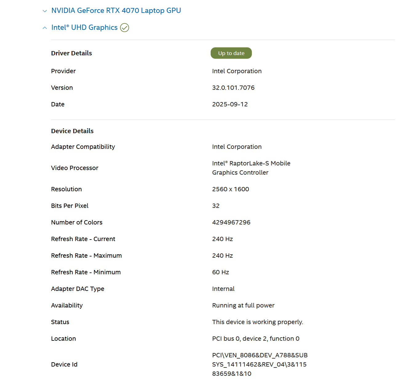

Not sure where to start and how to explain everything. Bought Msi Sword laptop early September 2025. In the start no issues at all. Everything run great, even some gaming sessions. No roughly issues like most people having with thermal throttling etc.
Just now, like in the last 5 to 7 days, started to experience intel UHD Graph spiking to 80-100%, so having insane input lag issues and display stuttering even without running any programs. I only open task manager and try to move it around screen and instantly UHD spiking to 100, meanwhile my RTX 4070 is usually at 0 - 8 % usage, while at worst my CPU is running at ~30%. Opening anything or switching in between programs take way too much time. Even highlighting anything is extremely laggy.

All the issues started without any updates installed. Now I have tried to update windows, all the graphics divers, Geforce etc. Though Intel driver @ support assistant, also tried MSI center, Geforce control panel/ experience, also the Intel Graphics software. Intel Processor Diagnostic Tool test but didn't say that anything is wrong.
The only thing that only sometimes helps, if I go to device manager, disable 1st UHD, then RTX 4070, then Monitor driver, and the re-enable the UHD and RTX.
Also tried to revert the drivers, uninstall, reinstall. At this point of time im not sure what to do. The only thing i haven't done yet is reinstalling windows, but I doubt that would fix anything.

Good evening Sir,
First things first, right after this post that I made, tried DDU safemode removing all the drivers and after reinstalling everything. It completely bricked my windows! So I had to re-install the Windows. Now the issues are gone, although Im afraid now to do any updates, I haven't even installed the MSI center app.

6. That's also a thing I don't fully understand, since I have 4070 why would it maybe at best use only like 4% of the GPU meanwhile the UHD doing most of the job, while in Nvidia 3Dsettings I have set to the Nvidia process and Physx to 4070.
I attached the ISSU report.
