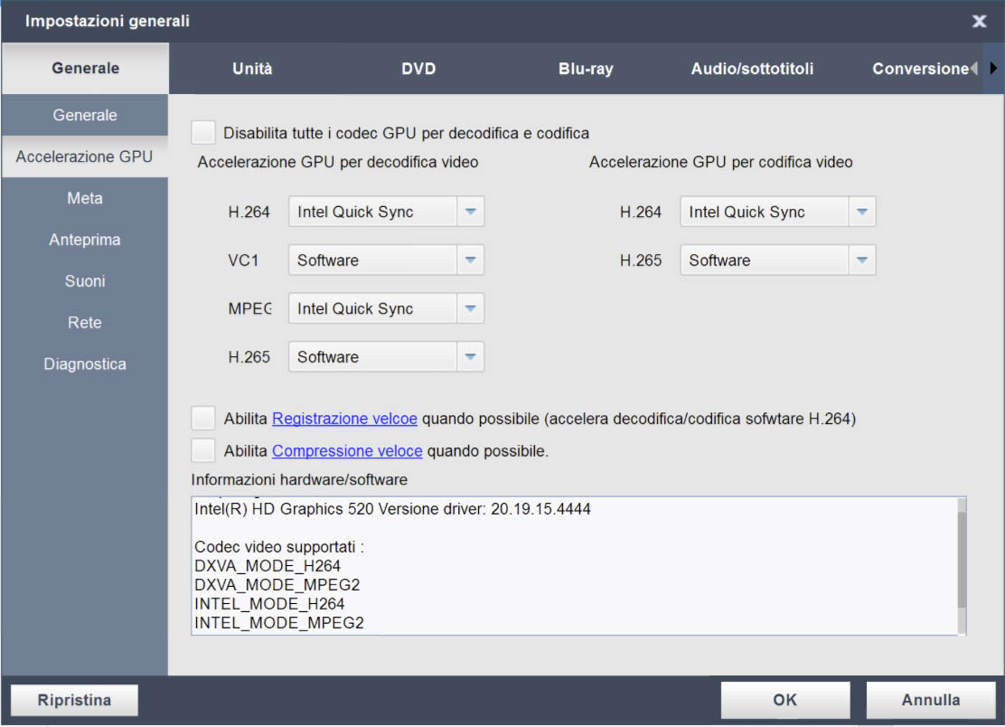

Hi, I've a NUC6i3SYH with Intel HD 520 graphics.
My OS is Windows 10 Pro 64bit, graphics driver 20.16.15.4444.
I want use it as HTPC (decoding) and to convert video to h.265 video format (encoding).
To do it I use DVDFAB software that support intel quick sync hardware acceleration but I can't enable it into this software preferences: only HEVC software encoding (very slow) is supported.
I'm not sure IQS is enabled or not, is there a way to verify it's working?

Hi Ivan,
Thanks for your reply.
As you can see from my DVDFAB preferences settings, it can decode and encode HEVC but only software.
Skylake cpu supports HEVC hardware decode and encode functionality but I don't understand if need to activate they or not.
Could you tell me if there is a way to know if Intel Quick Sync is working?
Do you know if there is a video converter that supports HEVC hardware encoding and decoding?

Ok I did some testing, and I found a problem.
Hardware decoding worked only when I was using DXVA hardware acceleration, but not when using quicksync.
So it seems that the quicksync it doesn't encode/decode H.265 content ...
I don't know if it is a bug in driver. I think Ivan can tell us why H.265 codec is not working when using quicksync directly, because in that documentation, on page 28, it's written that it should support it .

13,093 Views
I think so!
Using DVDFAB that should support h.265 IQS encoding hardware acceleration don't show it among the possible choices.
Waiting for Ivan...
