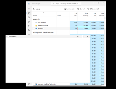

We completely understand your comments. In reference to your questions about the lab we have performed, please see the SSU and two videos attached to this post.
In the videos from our lab, you will be able to see the memory usage for the application while running on Intel® Graphics with driver 3790. We ran the project with no debugging and you can see the WpfTest stayed at around 15 MB of memory usage.
While starting the project, and also debugging the WpfTest increased to 23.5 MB of memory usage, which is expected and is way less than the increment presented in this scenario.
If you have more questions or need more details about the tests we did, please let us know so we can further asist you.

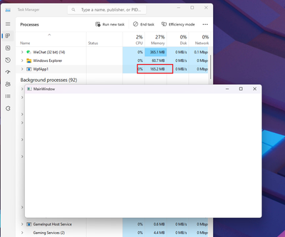

I have the same issue on i9 13900H CPU with Iris XE graphics.
Even a pure empty WPF app takes 165.2 MB on startup. This is a .NET 6.0 WPF application, not .NET Framework, same issue.
It is normal on other machines
I am using the latest driver 31.0.101.4255, the issue is still there.
Just like you said, disabling the CPU integrated graphic will make WPF memory usage normal. But using software rendering or disabling Iris XE isn't a solution.
I created an issue in WPF repo for Microsoft to investigate the problem.
https://github.com/dotnet/wpf/issues/7704
