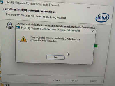

Then I installed the Lan_Win8,164_20.1 driver from my archive hoping to fix those two remaining issues but got the following error message instead.

I'm not really sure what drive it's talking about.  It's a nuc.  So maybe it's the wrong driver?

Are you using Windows 8.1? This installer is not set up for Win10 or Win11.

No I'm on Win11.  I was just hoping it would resolve it but obviously it didn't.  So any other ideas how I can address those two remaining issues?
