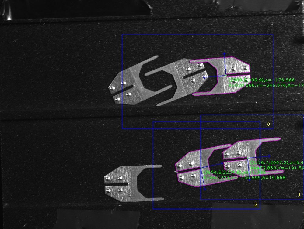

I updated my graphics driver from 101.4369 to 101.4577, to check if my DPC++ application can get some performance boost with the latest driver.
The application is the same as mentioned in the following thread:
Unfortunately, the performance with the new driver is 12% slower than the old driver under the same hardware(A750 GPU) and application settings.
In another application setup with fewer points but much more transforms, the performance degrades much more significantly:
The C++AMP implemention of the same application is also slower with the new driver.
Please help me to find out what happened with the new driver.
Thanks.

Hi Andres,
Yes. I cleaned the old driver with Display Driver Uninstaller (DDU) and then reinstalled the 101.4644 driver .
The applications seem to run slightly faster after the clean installation, but they are still significantly slower than 101.4369.
Thanks.

Hi Andres,
Application performance was measured by itself, using the standard std::chrono::steady_clock.
I have posted the application binaries and source code before. You can run the application inside a PowerShell window to see the performance measurements.
Thanks.

Hi Andres,
Here are the accurate steps the reproduce the issue:
1.Get a PC with i7-6700K, 32GB RAM, and A750 installed.
2.Install Windows 10 x64 22H2 with all updates to date.
3.Install WinRAR or any other archivers that can handle RAR archives.
4.Down load testdpc2-new.rar.
4.Extract testdpc2-new.rar into any folder.
5.Clean install the 101.4369 driver, restart the computer.
6.Open a command shell in the 'release' sub folder under the extracted folder.
7.Type testdpc2<enter>
8.Record the SYCL GPU Iteration time in milliseconds
9.Clean install the 101.4577 driver, or a more recent driver, restart the computer.
10.Repeat step 6.7.8,this time the SYCL GPU Iteration time should be significantly larger than the previous value.
Thanks.

Hello wdx04,
Thank you for your time.
We have been working on the reproduction of the issue, we tested it with different driver versions and there is not a big difference in the performance as we can see in the screenshots you attached.
In this case, our recommendation for further support is to make a post on the Developer Software Forums.
For now, we will close this thread. If you need any additional information, please submit a new question as this thread will no longer be monitored.
