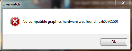

I've recently downloaded a new game called "Overwatch" that I'll need new graphics drivers for because of an error I'm getting. My current ones are very old (says 2011) (I don't know much about computers). Also, here are the minimum requirements: https://us.battle.net/support/en/article/7636 Blizzard Support.
I've tried many drivers from this site that appeared to match my PC but all of them said my computer didn't meet the requirements. When I ran the Intel Driver Utility software, it said that there were no drivers avaible for me, or that I didn't need any. (Which shouldn't be true...)
Here is the information I have from running dxdiag:

I'm also attaching the dxdiag.txt file. Please someone help, I'm so lost!

Chances are that you are getting that error due to the fact that your processor (Intel® Core™ i5-2450M Processor) has Intel® HD Graphics 3000, and as per the minimum requirements for that game, the lowest are Intel® HD Graphics 4400 (from more recent processors).
In this case, my recommendation will be to check with Blizzard* to find out if it is possible to play that game with your current system configuration.
