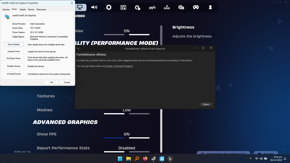

I just tried using the current latest non-WHQL graphics driver 32.0.101.6127, and this is what I got:
Made my display pixelated as well. Not the first time it has happened. I've also had crashes but the crash reporter never showed up, maybe this can be investigated as well?

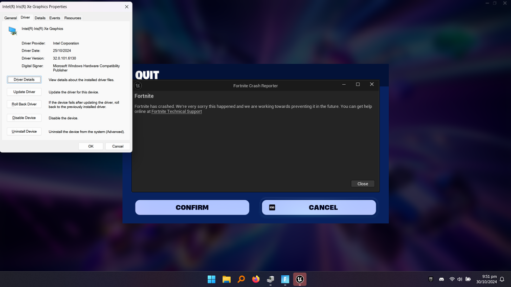

You forgot to edit step 3, since it's saying about telling the user to do that. But anyway, the driver version 32.0.101.6130 still crashes, as seen in the screenshot below:
Here's the link to the dump files for the crashes that occurred from driver version 32.0.101.6127 to 32.0.101.6130, I hope it's anything useful:
https://drive.proton.me/urls/QYC0C63K4M#b8WDCCkNj6LX (Just click the download button)

Still the same issue.
Looked into the crash logs for additional info and it says:
LogD3D11RHI: Error: Result failed with error DXGI_ERROR_DEVICE_REMOVED DXGI_ERROR_DEVICE_HUNG
at D:\build\++Fortnite\Sync\Engine\Source\Runtime\Windows\D3D11RHI\Private\D3D11Query.cpp:366
