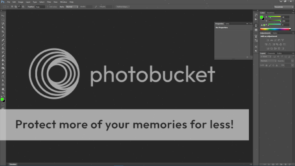

Hello all. I was looking for help regarding a problem with my laptop.
I recently updated my laptop to latest build of Windows 10. But, after the update, now there are random "snow" dots (sort 0f flickering) appearing across the screen.
http://i1033.photobucket.com/albums/a418/kautsar_21/white%20dots%20problem_zpsegc4qlee.png http://i1033.photobucket.com/albums/a418/kautsar_21/white%20dots%20problem_zpsegc4qlee.png http://i1033.photobucket.com/albums/a418/kautsar_21/white%20dots%20problem%203_zpsari06plu.png
Those random dots always appeared each time I restart my laptop. If I shut down my laptop, then turn it on, the dots won't appear.
If I restart again, dots will apear again.
I tried booting my laptop to Safe Mode, and the dots disappear during the Safe Mode.
I assume this has to do with my Intel(R) HD Graphics. I have two Display Adapters on my laptop, Intel(R) HD Graphics 530 and NVIDIA GeForce GTX 970M.
Disabling Intel(R) HD Graphics Device,Uninstall the driver, and/or switching the driver with Microsoft Basic Display Adapter will remove the random dots, but the problem returns when I restart the laptop.

13,797 Views
I already tried the update. But after I restart my laptop, the problem still exist.
The confusing part is, if I turn on my laptop from start (after shutting down), the dots won't appear and the screen back to normal.
But, each time I restart, the dots will appear again.

Hello Kautsar,
Thank you for your response,
Up to this point we can only conclude that the issue is a hardware issue and not software or driver-related. In this case I strongly recommend to get in contact with Asus for any possible hardware issue help. I apologize for any inconveniences.
David V
KNurf
13,797 Views
So, I brought my laptop to service center, and got some replacement on the monitor and other parts (maybe motherboard)
Anyway, thank you for helping me with this issue.
