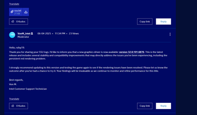

rafay19
2,168 Views
BRO THEY REPLIED ME THIS CAN U TEST THE GAME ON THIS DRIVER
PepoIRISXEl29
New Contributor III
2,158 Views
No fix man, the game still looks al redish and black.
PepoIRISXEl29
New Contributor III
2,156 Views
June 5th Update: recently installed the lastest driver update 32.0.101.6876, there's no fix yet. The red rendering problem persists
