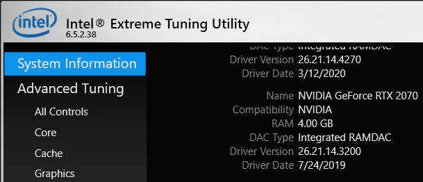

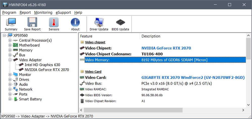

XTU reporting wrong amount of RAM for a GTX2070 (GV-N2070WF2-8GD).

Hello automous,
To better assist you, please provide the following information:
  •  What is the model of your processor?
  • What is your operating system and its build?
When talking about the graphics memory reported, it is important to highlight that Intel® XTU is not designed to report/monitor third-party hardware. In this situation, the information that the tool is providing about this NVIDIA® Graphics card may not be accurate.
I would recommend using the tools provided by NVIDIA® to confirm proper graphics functionality.

Hello automous,
Thank you for your response and the information provided.
I wanted to test a previous version of the XTU software to determine if you will experience the same behavior.
I would like to clarify that as you say, the latest version of the Intel® Extreme Tuning Utility is 6.5.2.38.
The main difference between both versions is that the version 6.5.1.360 is the last version that will support the legacy profiles database.
You are running the latest version of the software and it is recommended to use that version.
However, after checking the hardware specifications of your unit, we can determine that the processor is not supported by the software. That is the main reason why the tool is not showing accurate information.
The tool will support only processors with K or X numbers.
Please search for your processor in the list under "This download is valid for the product(s) listed below"
Again, I would recommend using the tools provided by NVIDIA® to confirm proper graphics functionality.
