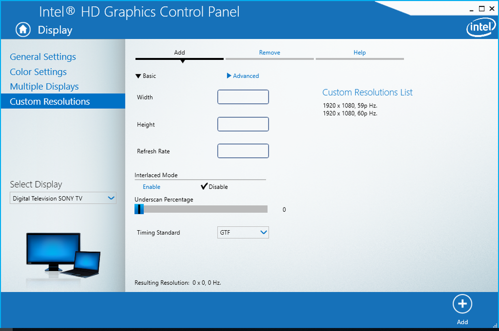

Much to my surprise, if a set 1080p 60Hz and 1080p 59Hz custom resolutions I am able to record lossless 720p - signal status is 1280x720p 59.94Hz. And both Skylake systems work, with splitter!!! Big thank you for staying committed to this problem.

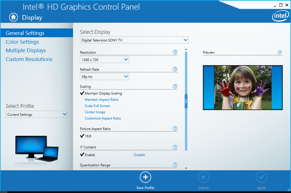

Notice the resolution change pop-up message on the top left corner of the TV. I'm on 720p on the desktop, it changes to 1080p as I start the benchmark, and goes back to 720p as I cancel the benchmark run. This is the very same thing I get on my capture card.

I can capture correct 720p footage from both the i3-6100 and the i3-7100 - still have to apply 1080p 59Hz and 1080p 60Hz custom resolutions.
In some games I have to set the refresh rate from Auto to 59Hz.

I have to apply 1080p 59Hz and 1080p 60Hz custom resolutions in the Control Panel to get proper 720p signal. This works most of the time.

The problem is not with my recording setup, as a Sony Bravia TV also produces the issue. You can see how the resolution change notification appears in the top left corner. Desktop 720p, I set 720p resolution in the benchmark, but as it starts the resolution notification appears and says it's on 1080p.
