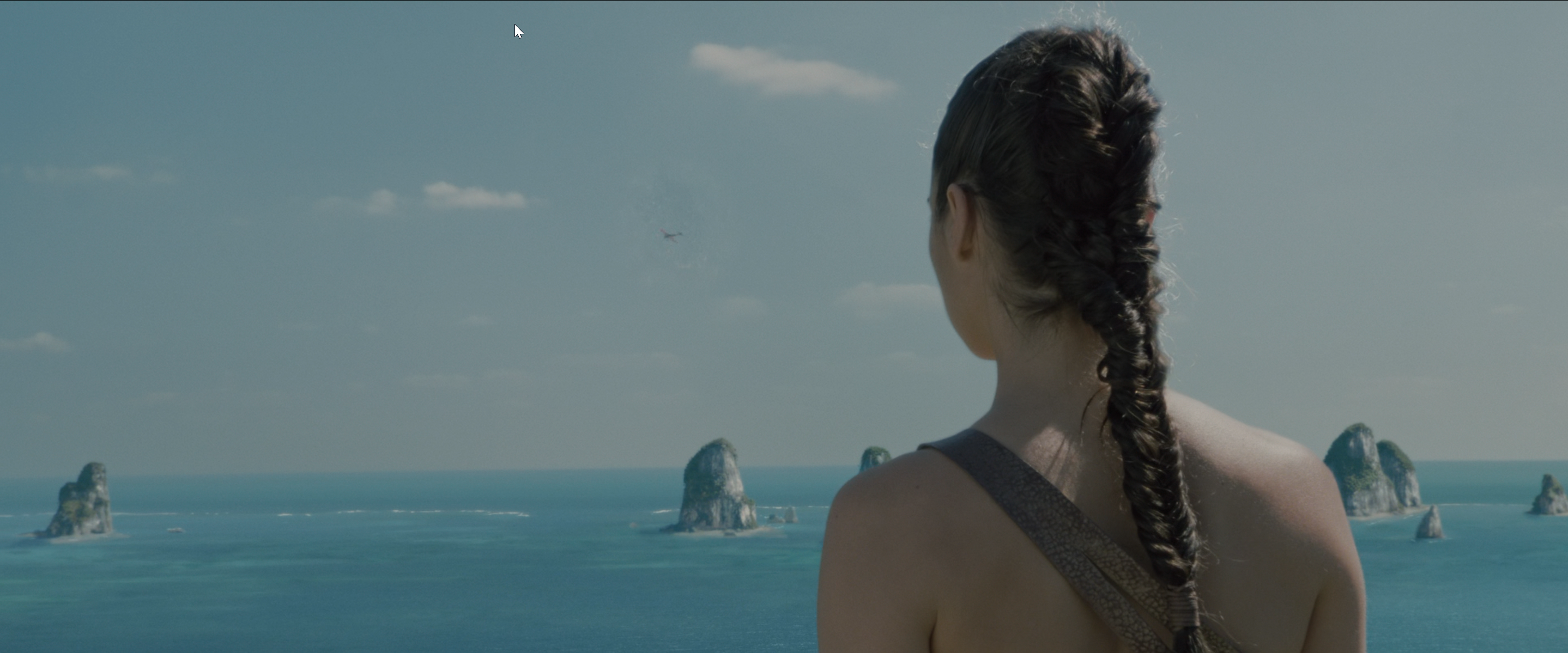

If a video file contains Matrix BT.2020 (mostly HDR), color distortion will occur when playing it with Enhanced Video Renderer (aka EVR), see the screenshot below:
sample1 (normal is: this)
sample2 (normal is: this)
sample3 (normal is: this)
sample4 (normal is: this)
Here is test sample videos download for you.
This problem occurs on all 7th kabylake and above GPUs. While AMD and Nvidia GPUs don't have this problem,  the 'normal' screenshots above are made on AMD/Nvidia GPUs.
I tested it with more than 10 different GPUs (amd/intel/nvidia) for two days to confirm.
I asked some media player developers, and they replied that Intel's driver automatically converts BT.2020 to BT.709 with EVR (EVR uses dxva2 video processor), while it has a "bad" conversion which leads to color distortion like those screenshots.

First, this is not a coding/software issue. The reason why I use MS Graph Edit is just for a more intuitive demonstration. "A video decoder + EVR" is very intuitive and clear in MS Graph Edit.
Second, I have already contacted the authors of GraphStudioNext and the authors of various media players, they all replied that "Intel's driver automatically converts BT.2020 to BT.709 with EVR (EVR uses dxva2 video processor), while it has a "bad" conversion which leads to color distortion".
This is not an app/software problem, but an intel problem. And because I have already said, I tested it for two days on the AMD/NVIDIA platform, the same operation, there is no problem at all.
Third, I will use a media player to reproduce the problem for you.

I watched your record, you are  facing the same color distortion as me.
Please check on NVIDIA or AMD GPUs, that's different.
IMHO, I find it's difficult for you to understand my feedback. I have already posted a lot of screenshots in the main thread, no more need any detail.
Maybe other customer Support Technician can know what i mean, please.
color distortion:
noraml:
color distortion:2.png
normal:
color distortion:
normal:
color distortion:4.png
normal:
Is it clear? on nvidia & amd gpus, always normal screenshot.
(Notice: don't use Enhanced Video Renderer (custom presenter) in MPC-HC, just use Enhanced Video Renderer, Enhanced Video Renderer is microsoft's native video renderer)

I am sorry if you feel like we are not helping you with this issue, we are trying our best. We did notice a difference related to the color's palette, but this could be affected depending on the monitor/TV you are using. We check with a DELL laptop and an external monitor and we can see a difference only on the external monitor but not the laptop (this is just for you to bear in mind).
