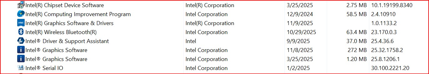

can not seem to get rid a of old entry in the program features i can install the new drivers and do a clean install but it dose not remove the old one I DO NOT NEED A THE NEW DRIVER . I NEED THE OLD DRIVER when i try to uninstall the old one IT TELLS ME IT NEED THE OLD FILES 6.1 EXE TO REMOVE IT AND IT CAN NOT FIND THEM I DID A SEARCH AND IT IS NOT ON MY COMPUTER SO I NEED THE OLD DRIVER SO I CAN INSTALL IT THEN REMOVE IT THEN DO A CLEAN IN STALL ON MY LAP TOP AND DONT TELL ME TO IN STALL THE NEW DRIVER IT DONT WORK . see up load and were did my last post go  new ver 25.32.1758.2 old vers 25.8.1206.1 software i also now notice another driver installed ver 1.0.1133.2 the ver 25.8.1206.1 is the one i can not seem to uninstall and there dose not seen to be a old installer with that ver # to get  so i can in stall it and remove it

here is the file the uninstall is looking for  can not seem to edit my post no edit button .
C:\Users\zed20\AppData\Local\Temp\RarSFX0\Resources\Extras\IntelGraphicsSoftware_25.8.1206.1_Release.exe

here is another screen shot
zed201
4,412 Views
this is with all intel video driver removed  it still show one installed i can not get it to remove from program features but the uninstall shows it being removed

Look no further. I happen to have the necessary files in my archive. It is driver package 32.0.101.6653. I have uploaded a ZIP file providing this package (and related documentation) to my Other Legacy Drivers share. The file you want is GFX_ARC_Win10-11_32.0.101.6653.zip. Extract this ZIP file to a temporary folder and then, using a smart tool like 7-ZIP, open file GFX_ARC_Win10-11_32.0.101.6653.exe as an archive. You will then be able to extract the folder structure needed.

I went through the same process as OP while cleaning up my installed apps. I noticed there were 3 entries for the Intel Graphics Software, all with different versions.
I was able to find installers to remove 2 entries, but the only one I couldn't remove was "Intel Graphics Software" version "25.8.1206.1" which I installed in March 2025.
When I try to uninstall it, a popup window opens asking me for the file "IntelGraphicsSoftware_25.8.1206.1_Release.exe" which I don't have. This file is supposed to be bundled inside a typical driver file "gfx_win_101.6653.exe".
Thanks to @n_scott_pearson for providing the correct driver file name! Searching for "GFX_ARC_Win10-11_32.0.101.6653" on the web pointed me to Softpedia - Intel Arc Graphics Driver 32.0.101.6653 64-bit.
Once you download "gfx_win_101.6653.exe", use WinRAR or Total Commander to extract the file. Then the file "IntelGraphicsSoftware_25.8.1206.1_Release.exe" will be inside "Resources\Extras\" folder. It's a 115MB file, and I wish Intel still hosted these older drivers just in case for people like you and me.
